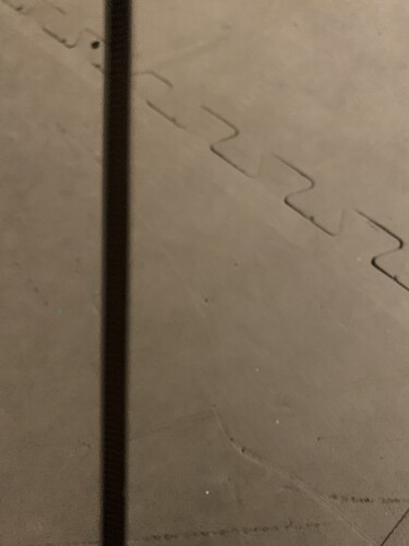

Well 3 wire ports have 3 wires while the v5 cables have one. And the 3 wire ports have more ports then the v5 cables do because it must support all 3 wires. 3>1 so 3 wire is best. And I am Marcus
Where did you get 1 from?
This looks like 1 to me.
If you strip the black cable, you get 4 cables. It is 3 cables. Look near the connector. There is green, black, blue, and yellow
