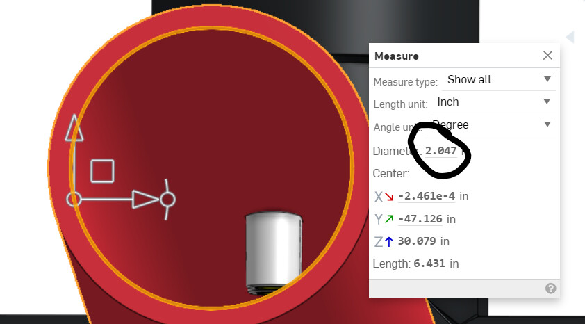

What is the inside diameter of the elevation pole? I could only find the outside diameter in the game manual.
The inner diameter is 2.047 in
Here is the onshape file link:
Thank you! Just to confirm, this would mean that the pipe is 0.333 in thick, right?

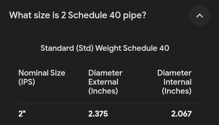

Around that yes. The elevation bars are made of 2’’ schedule 40 pipe, so their measurements should’ve looked like this:
