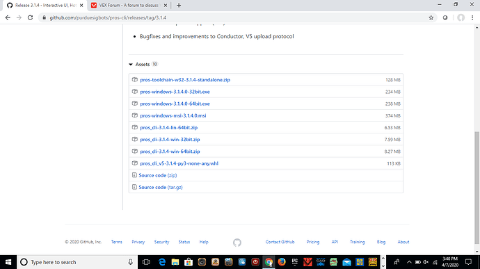

I am trying to download pros and I don’t know what to download. There are a lot of choices to choose from. Any help would be great
Based on the applications you appear to have installed, your system is almost certainly 64-bit. Thus you want pros-windows-xxx-64bit.exe.

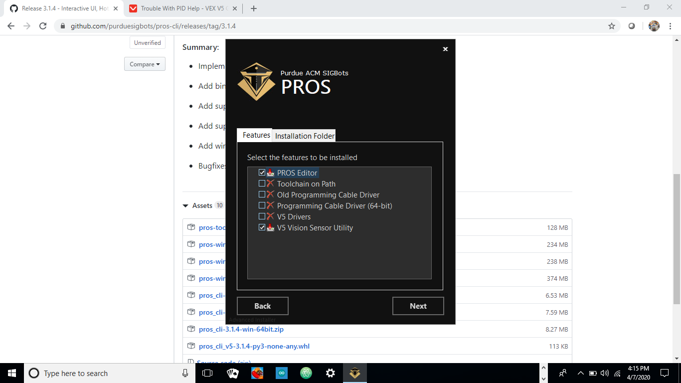

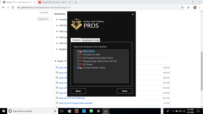

which of these are best?
The PROS Editor is the optional Atom editor preconfigured by the PROS team. I do not recommend it; see this thread for more on that.
Unless you already know you need it, you won’t need the toolchain on PATH.
Same for the old programming cable driver — unless you already know you need it, you won’t need it.
If you will be doing Cortex programming, you will probably want the programming cable driver; that will allow you to download wirelessly through the controller.
You will need the V5 drivers for V5 programming.
The V5 Vision Sensor Utility will help you configure and use the Vision Sensor, if you have one and are interested in using it.

64 bit computers have been around for a while. That Aspire has a Pentium B960, which is a dual core 64 bit CPU. An old one, but its still a 64 bit instuction set and should be able to handle 64 bit programs on paper.
never knew that lol. thanks. I was kinda worried that it was a 32 bit.

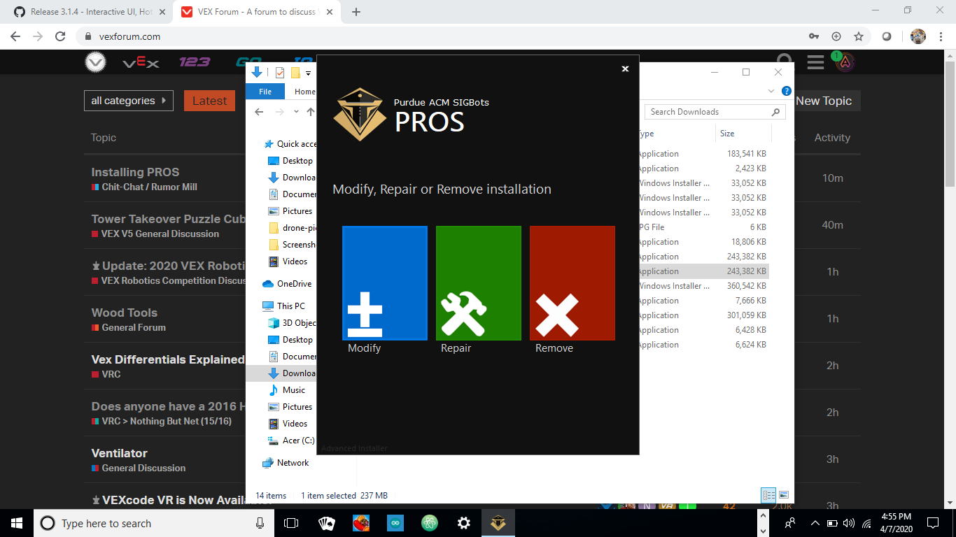

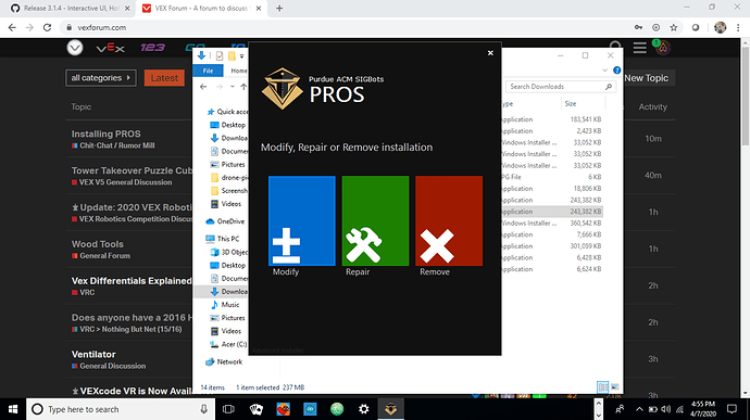

now it wants me to do this when I went to files and clicked open
You opened the installer again. To use PROS, you need to create a new PROS project and open it in a text editor.
Assuming you did not install the PROS Editor:
  1. Open Command Prompt (search for it in the Start menu)
  2. Type the command mkdir %USERPROFILE%\Documents\PROS to create a folder called “PROS” in your Documents folder, where you can store your PROS projects. Press Enter to run the command.
  3. Run the command cd %USERPROFILE%\Documents\PROS to ‘move into’ the previously created folder for running future commands.
  4. Run the command prosv5 conduct new-project MyFirstProject v5 to create a folder “MyFirstProject” inside the previously created “PROS” folder. The “MyFirstProject” folder will contain your PROS code.
  5. Open and edit the .cpp and .h files inside the “MyFirstProject” folder and subfolders in your text editor of choice. This is your actual PROS code.
  6. When you are ready, run the command prosv5 mu to upload your code to a connected V5 Brain. (You will need to move into your PROS project directory if you are not already there — simply run the command cd %USERPROFILE%\Documents\PROS\MyFirstProject).
Of course, this may seem daunting and tedious at first glance, but it’s really not too difficult.

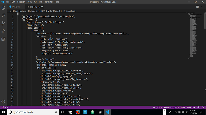

I have no clue what any of this means lol. am I on the wrong thing?
This clears up a lot. I thought pros was an application that you could open and code on. thank you

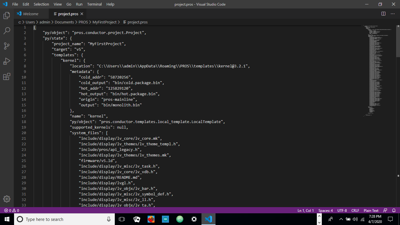

Don’t worry about project.pros right now. The .cpp and .h files are where your actual code goes; focus on those instead.
If you click the top icon on the left sidebar, that looks like a stack of papers, it will open the Explorer and show you all the files in your PROS project.
