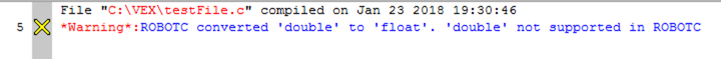

There are no doubles in RobotC.
Use floats for any non-integer quantity. Use ints all other times.
oof, i thought there were doubles, must have been mistaken
The language allows the type, but it generates an informative warning. Here’s a short test program I just compiled:
task main()
 float scaleFactor;
 double scaleFactor2;
 scaleFactor = 1.1;
 scaleFactor2 = 1.2;
And here’s a screenshot of the warning generated:
