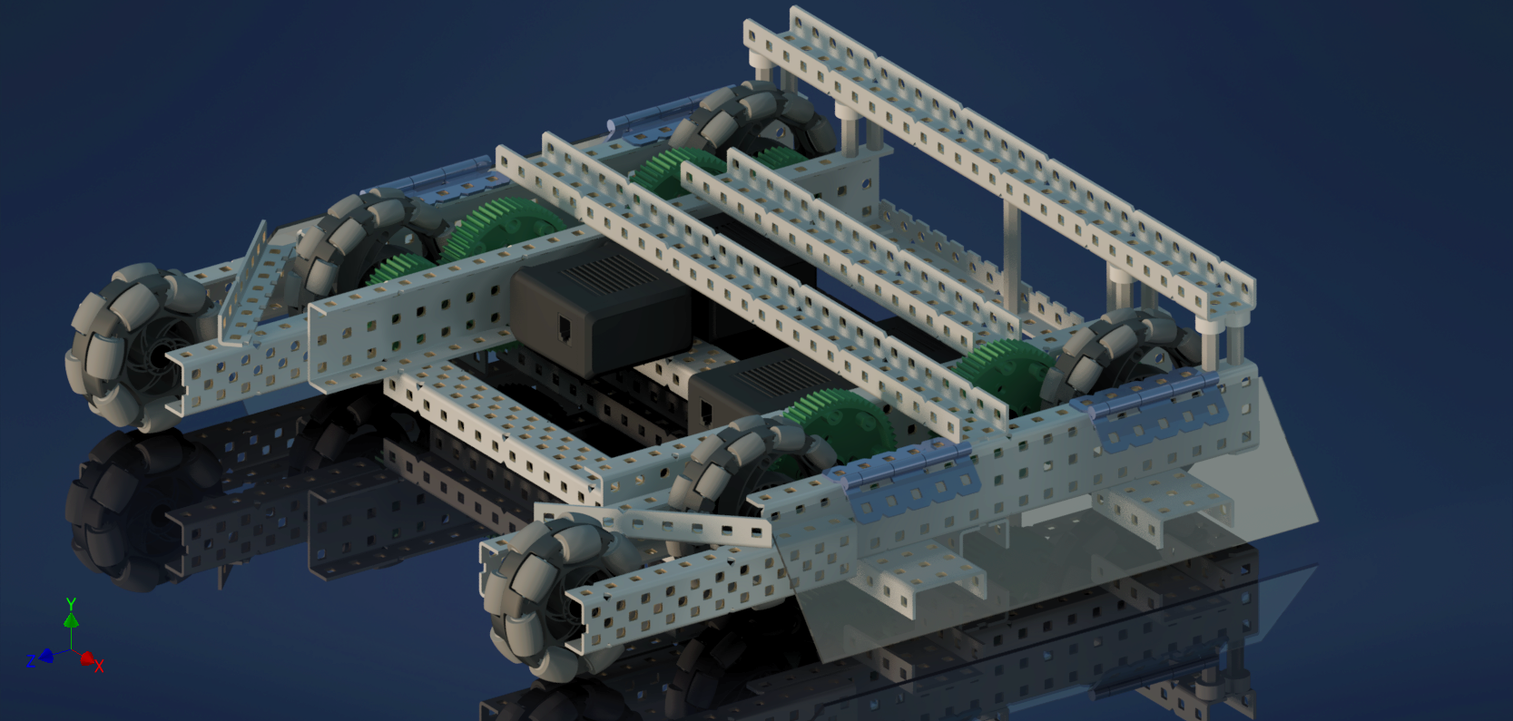

So obviously in Change Up most people attempt to make their intakes contact at the center of the ball (3.15"). The issue that I have continually faced with this is that the roller is limited in how low it can be placed by the presence of the wheel. Since my drivetrain is not super wide (to allow sideskirts), the wheel falls near or directly under where the intake needs to be (24t sprocket china rollers). The best solution I’ve found to get around this is just doing a thin back roller which is the one over the wheel and a normal width front roller and then lowering that one to the height of the midsection. This has all been done in CAD so I haven’t been able to test how efficient it is. The other problem is that even if the intakes are somehow placed inside the wheels, they need to be able to pivot outwards to descore the center, meaning they will hit. That adds another dimension of difficulty so it is basically impossible to get the back roller below 3.50" inches or so (and that’s with 3.25" omnis of course).

  1. I only really have a quarter of an inch worth of space from my intake and wheel, mind you I am using flaps so that makes my intakes slightly longer than a 3.25 traction wheel.
  2. My intake rollers do not hit the center of the ball. I have the same issue as you with my wheel being in the way. However I was able to tune my intake and they were able to work magic regardless. Plus you need to take into account that when descoring the balls will come in to your intakes at a higher point of entry.
  3. Yes my intakes can descore from all towers including the middle ones.
  4. Staggered intakes so that my intakes can wrap around the center goal. However, that is not necessary as we’ve seen teams be able to ‘punch-out’ the center goal balls without running their intakes.
  5. I am using 3.25 traction wheels at the back and flap rollers on 18 tooth sprockets at the front.
  6. In my experience, that would be a big NO. Your intakes all depend on the correct spacing, speed, and compression to be efficient. Remember, every robot has different intakes, so each robot’s specifications to make a good intake are different. Make sure to take your time and test out after each fine-tune to make sure it is just right.

I use 3.25 in omnis but they don’t affect me. What does is the 2.5 inch omnis because you can think of them as an anti tip but they are a structured piece. This is below my intakes and took me a while in cad to make sure it was as close to the center as possible. Here is a picure of that anti tip thing if you are wondering.
