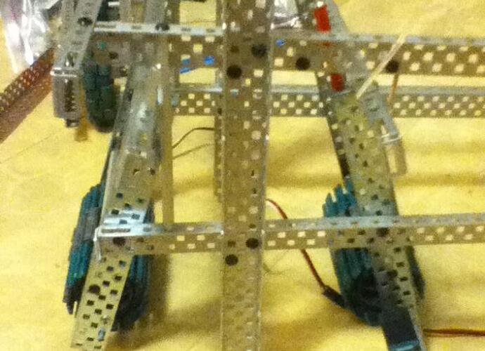

We are currently prototyping intake designs. We noticed that using the small black rollers is too slow so we moved on to larger bore intakes. The pictures I attached is a version of one of the intakes we prototyped that sucks in and spits out (plastic jars because we are improvising) very smoothly. We also designed it to release game objects one at a time to aid in more efficient autonomous scoring (the intakes can be adjusted to open or close almost acting as shocks to accommodate the different sized game pieces). Probably not what 3008A is going to use for Mckinley Vexhibition because it uses up two motors. No idea if intakes will be better than claws though. Perhaps a hybrid might be the best option :wink: We’re going for tank as well, possibly a drive with more than 6 motors.

I think a good idea, if done effectively, wold be to get all your colors, then put them in a bucket, then (with some SERIOUS power) put all of them in a bunch of diffrent goals. (kinda crazy idea, but if anyone does this, please post pics! ;)) But I think the main strategy for this game is speed. Ex. getting to the goals first. I think a Titan lift (with a little bit of ingenuity) could get the job done for the lift.
Anyone using this idea should probably use two lifts. Our team used a Titan lift this past year, and the major problem we ran into was the weight of our claw pulling the slides out of alignment. Two lifts (one on each side) would help negate this affect.
