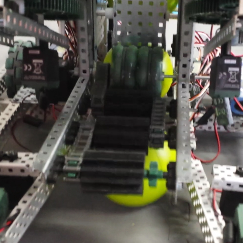

Here’s how are intake works:
link text
Go to about 0:55

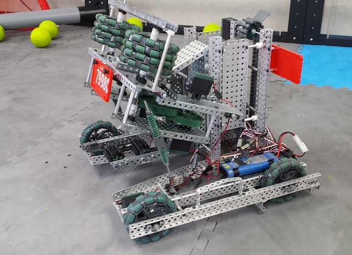

Rubber band intake would be hard to fit…
Don’t have a lot of room, any suggestions?
Why do you have the black intake rollers next to the wheels?
For space?
Mainly helps bring the ball to the intake
If you want to make room, here’s what I would do:
  1. Put the front motors in the back of the robot, and attach it to the front wheels with chain. This saves a lot of space because the motors wont get in the way of the intake.
  2. Remove unnecessary parts to free up space.
You should have enough space to put the rubber band intake after this.
I already have 12 motors though…
You don’t need any additional motors.
All you are doing is removing the motors attached to the front two wheels.
You can then put them near the back of the robot and attach then with chain to the front wheels.
This saves space.
