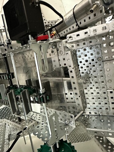

Hi, I was having some trouble with how my intake deposits the disks on the flywheel. I’ve tried a few different fixes, but nothing had worked so far.
could you send a vid of you intaking discs.
We have a very similar intake and flywheel placement and ran into the same problem. What fixed the issue for us was moving the axle that the motor is on, closer to the lip of the end of the intake. Placing the ending of the flaps on top of the end of the lip will stop the discs can’t fall into the storage area at an angle.
Ok, I’ll try in this when I am able to.
