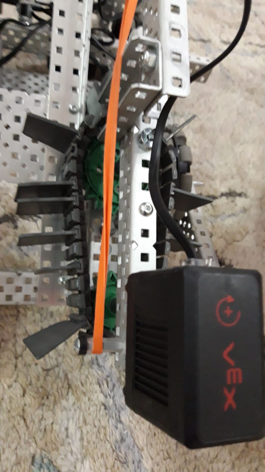

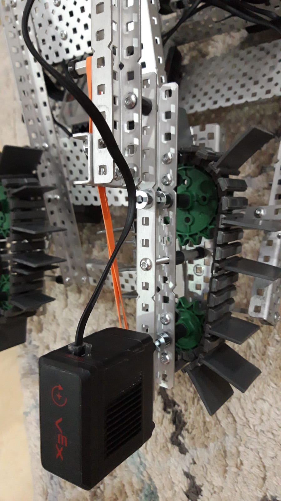

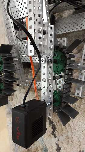

Intake problem with cubes
when cubes are taken in they go back how can i fix this ?

Ok I can think of a few things that could help so far; first, flip your intake motors around so they aren’t sticking out over the ends of the intakes, second, use white spacers on the intake joints with bearing flats so they have less slop, third, everything that pivots needs a bearing flat, otherwise your mechanisms will have a massive amount of friction and will wear through metal. Another thing you can do is add pegs by the sides of your arms near the intakes to hold the arms in when they intake so you increase compression.

And add bracing between your robot’s arms. 20200221_204250
