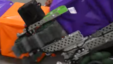

Something like this. These are from 7K and they are mounted on the intakes instead of the tray. They are like walls for your intakes. 7k wings
I have little intake wings as well, and they also help stop cube jamming. Just make sure they dont collide with the tray
Thanks, after adding these wings my intake works like a charm.
