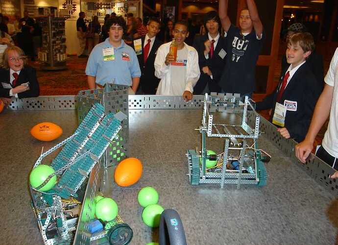

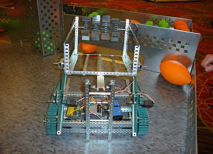

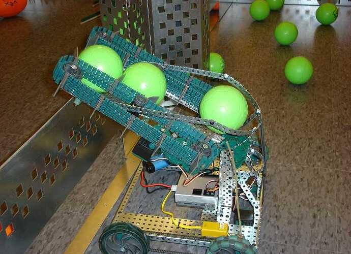

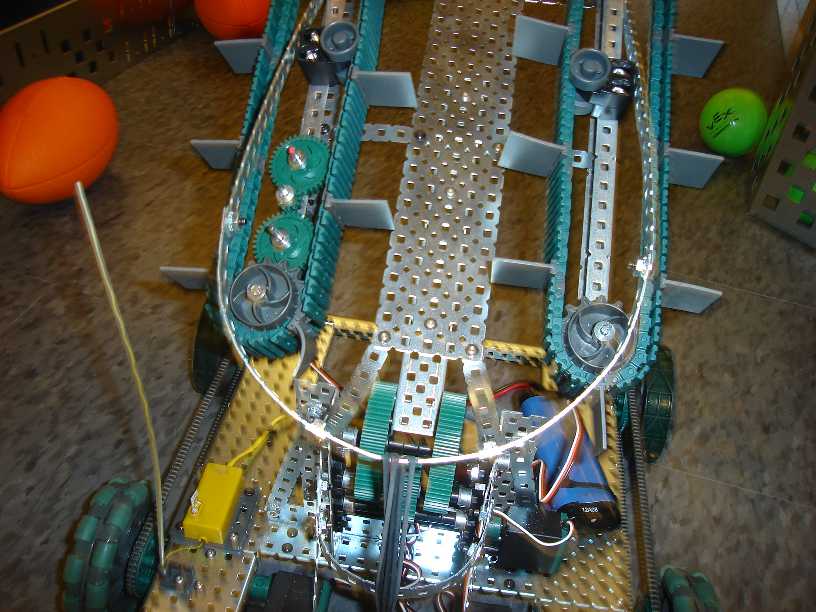

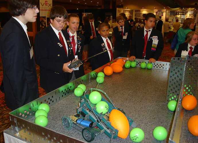

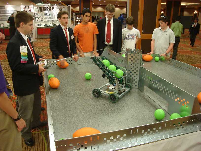

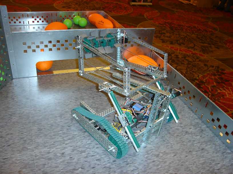

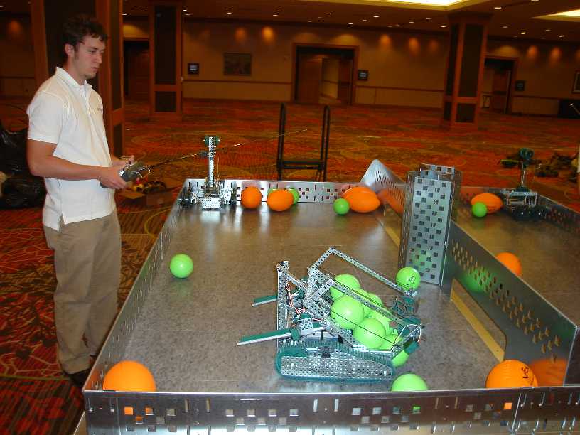

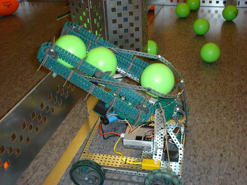

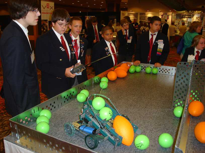

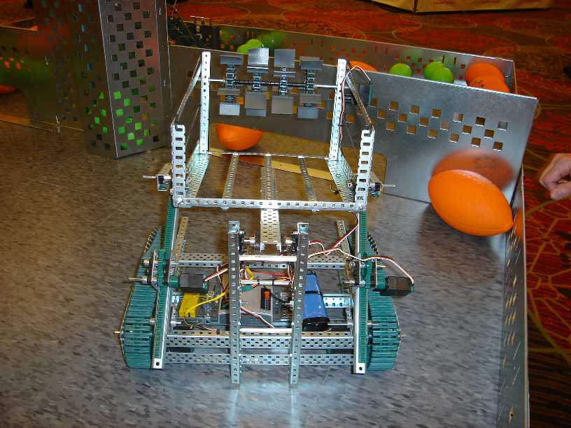

Hi Sunny,
There was a VEX demo at the Denver National TSA conference this past weekend.
IFI had the new mini Clean Sweep game set up (Called “Swept Away”).
It is done on an 8x8 field (Another new product) that just snaps together.
Some students from VRC148 (Robowranglers) built some bots for the demo.
See attached pictures and video here.
Note - These were just random shots - never occurred to me someone might want to see them - otherwise I would have done a better job of “Documenting.”
(hmmm… can only do 5 pictures at a time … see next post for more …)

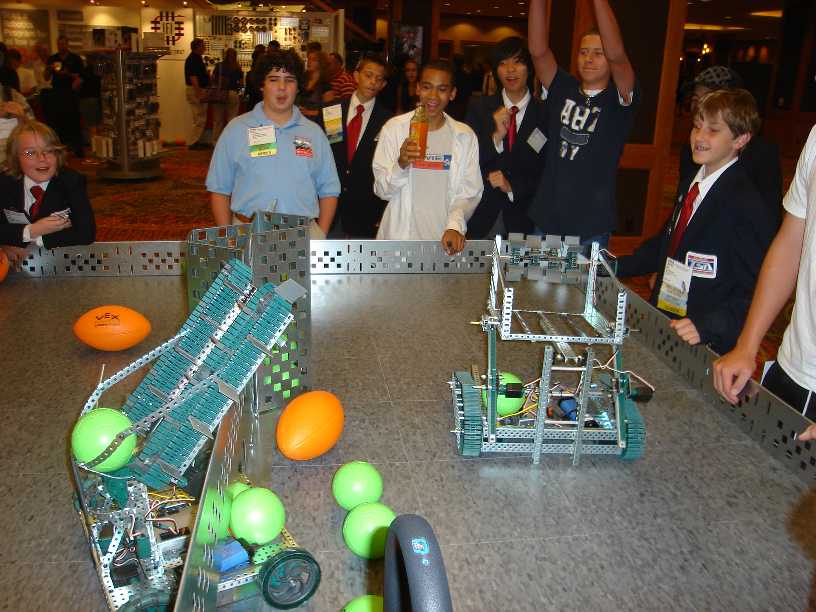

More TSA pictures …
Thank You very much for the pictures.
Hmmmm. That would make a very nice paddleboat.
I never thought of using the tank tread upgrades for paddleboat wheels but as I look at that shot they look perfectly suited for it. It’s interesting in that they could either be done as a wheel (above) or even as a long tread with the paddles in the water and the motors well above the waterline.

Yes, both of the balls do go “in”, but what happens when they get there? The problem I’m facing is that the balls in fact need to climb up a ramp, and even in the system in the video, the ties were bending a lot due to the large ball, and it wasn’t even going up the ramp!!!, But it’s alright, we have a temporary solution…that might work. :D.
