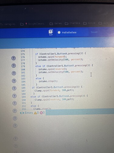

For some reason our teams intake is only spinning in one direction and I don’t think it’s the code since I double checked it and I didn’t change it and that it just suddenly on started spinning in one direction.

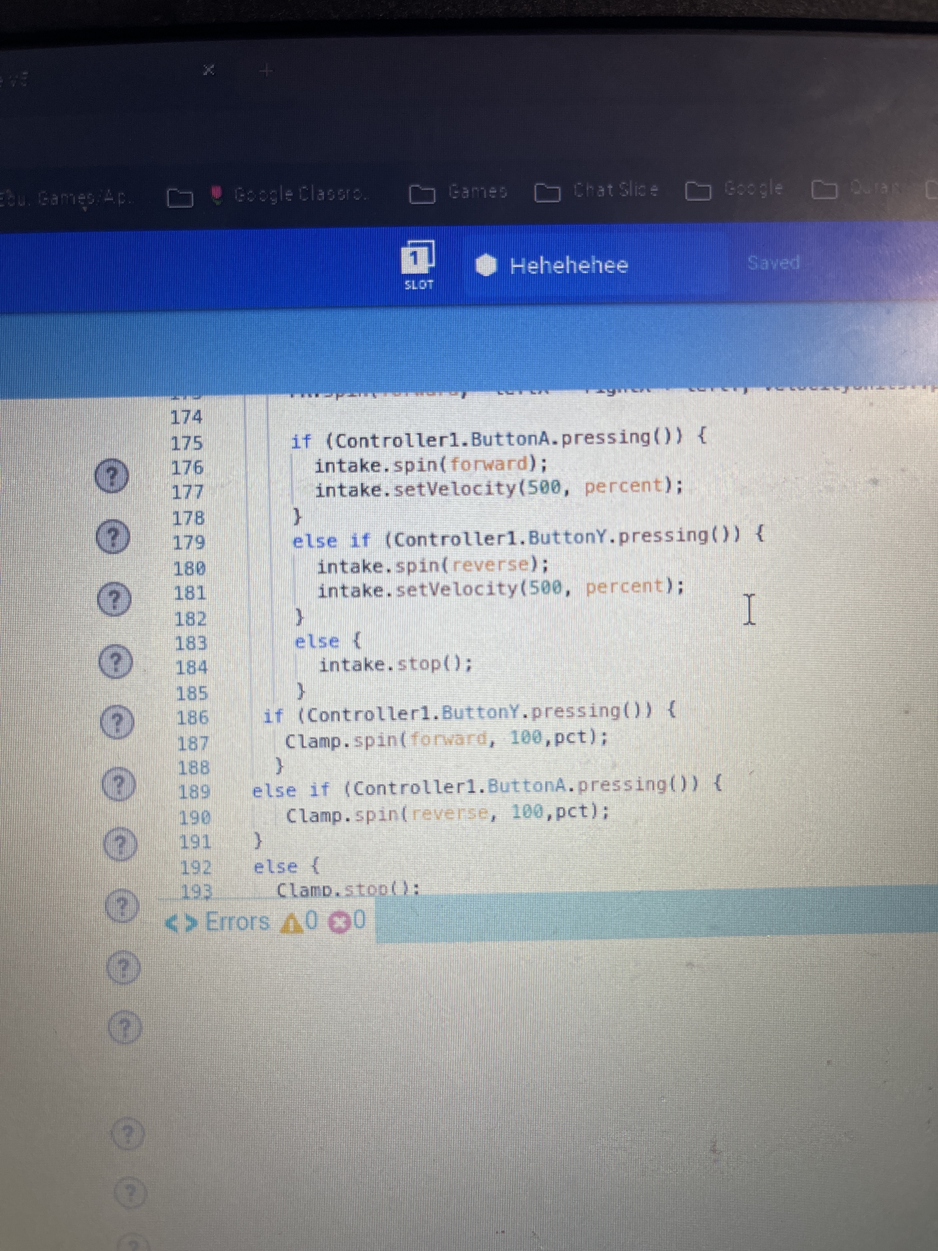

There’s the image of my code

Why are you setting the velocity to 500%?
Sorry that was me randomlyvtesting different velocity speeds to see if it would exceed the normal velocity.
Normally I keep it at 80-100

Sure, can you post all of it? Seeing 25 lines out of at least 175 lines isn’t helpful.
It seems your using the same velocity for forward and backward, try making the velocity negative and see if anything changes.

But I just wanted to let u know that it worked when I changed the velocity to negative
