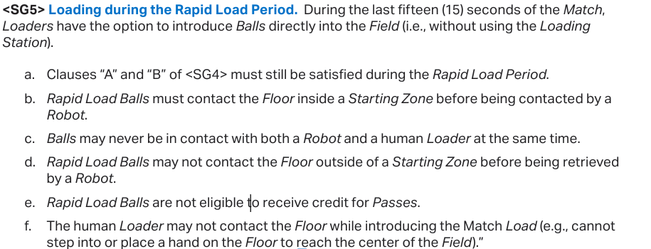

This is a question for the Q&A but I will give my 2 cents.
does say Loaders have the option to load Balls directly into the Field., so you don’t have to rapid load balls so you can still get passes. Clause e states that Rapid Load Balls are not eligible to receive credit for Passes, so I don’t think hitting the ball out will change its status. Rule might overrule this though.

yea, that’s what i’m thinking. There’s not anything explicitly stating a penalty, so I’m just here to double check.
You’ll want to check out the definition of “Violation” in the game manual.
Even if a rule doesn’t specify specific guidance, breaking a clearly stated rule is a violation, and referees will call them as is appropriate based on the rules. Those that have more specific guidance are there to help referees and teams better understand the intent of a rule and to help eliminate subjectivity as much as possible.
