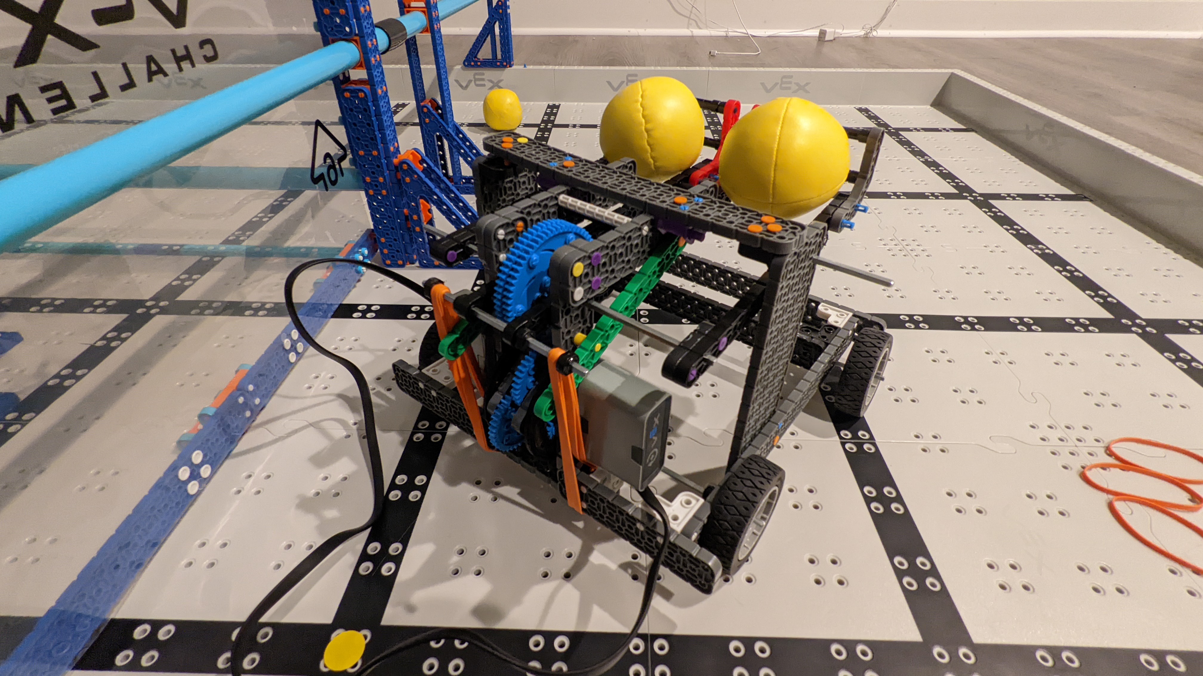

I’m looking to teach our kids a new method for launching the catapult (previous was choo choo), so I wanted to build out a demo myself to get one working before explaining things to them. I’ve found several user created videos that showed creating the mechanism and have a test robot created and working. The problem I’m having is it takes 8 rubber bands to fire with good strength, that seems like alot in general and in the other users videos I’ve seen, they don’t appear to be using that many either, so curious as to where I may have went off course.

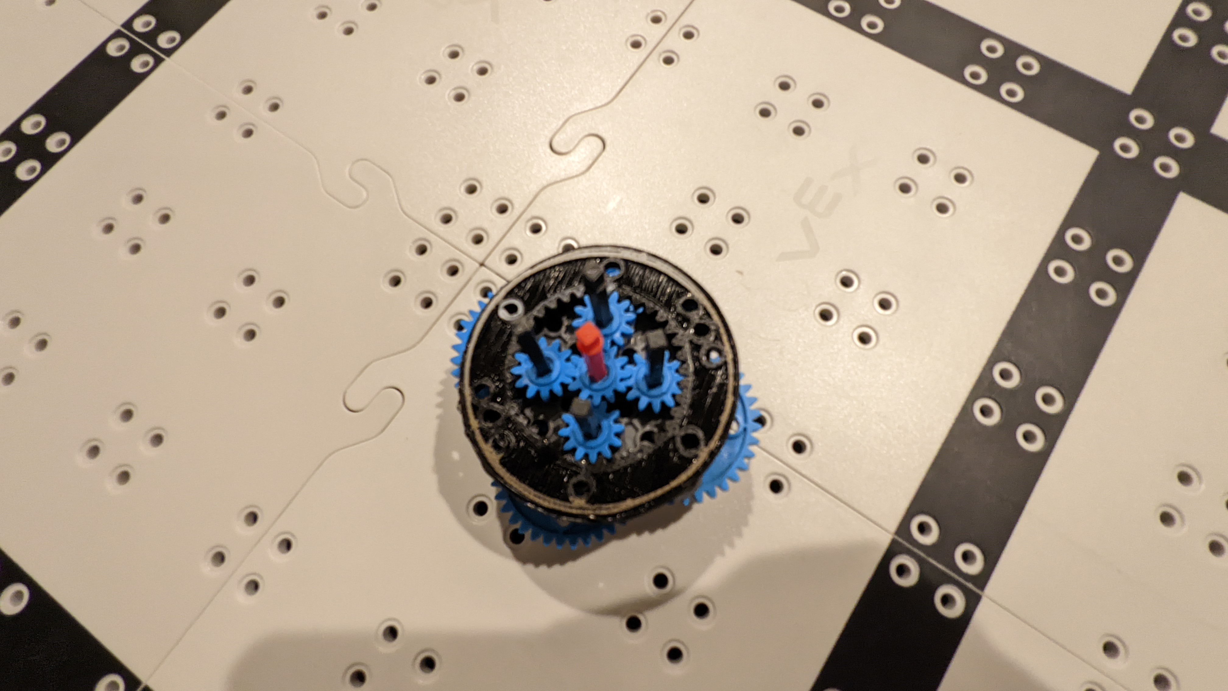

Pictures are below. I’m using planetary rings around the gear box (ignore the drive shaft length on the picture, that was more for modeling purposes), I have two motors powering the catapult (100% power and torque). I would prefer the rubber bands be in the front, some samples I have seen have the rubber bands in the front and work, yet I couldn’t get any real power off that way, so I have the rubber bands powering from the rear.
Have you considered using longer arms to give you some more speed? If you look at medieval catapults they have long arms as leverage.
When you are launching the balls from the catapult to get the balls a good rainbow motion you want to change to a little 25 degree angle, that may change the angle and most likely the balls will get in with less rubber bands.
I’m using 1x18 beams and at the current configuration, when the gears turn, the catapult arm is literally about 1/4" ish off the ground prior to release and launch. The robot measures 7 1/2" high in current state. I’m sure I could move everything up one notch and try to sneak in a little bit longer beam maybe we but I think that result would be minimal. But if you think it’s the answer I’m happy to try modifying that to see.
I have played with my stopper drive shafts so that the arm hits them right about a 90 degree angle to get the best arch.
The motors seem to really be pulling hard with 8 bands, it’s not a fast reload. Dropping down to 6 bands and it seems to reload a lot quicker like it should. But it’s not launching high enough.
It really feels like it’s a matter of placing the bands in the right place/angle and I think that’s the question. Also questioning if I have the best planetary gear configuration as well I guess.

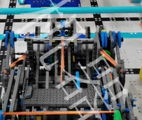

Here is the sample I’m mostly modeling after.
I also tried to make this design, but it cannot throw 2 balls. I wonder where we go wrong, when the rubber bands increase, the motors are very difficult.
Are you referring to the angle of the rubber bands? I have tried the rubber bands at different places and angles, the placement in the picture was the only thing I could get to work, but be it with 8 bands.
Have you tried putting a rubber band in the middle, possible that could add more power without adding tension on the robot.
Also I just realized this is not the lever, that is where I go wrong.
Yes, 8 rubber bands is a lot. But I wouldn’t worry too much about it in this situation because of the reason why you need so many. It’s because you are attaching them super close to the fulcrum of the catapult. Since you have less leverage for each rubber band, you’re going to need more of them.
You can fix this by extending the pieces out the front to attach the rubber bands further away from the robot. However, I wouldn’t recommend doing this because this means the rubber bands will be at an angle, something that can be detrimental to your catapult. Instead if you are really worried about it, you can try this. Since you are only “single wrapping” your rubber bands in that you aren’t “doubling them up” they just go from the top axle to the bottom 2x beam. If you them made them go back up to the shaft though, you wouldn’t need as many because you are stretching the rubber bands more and storing more potential energy.

@FRC973 Thanks Joe, I’ll try stretching them out further and see what happens. I’ll also try the smaller rubber bands since they are not as long. This may “cut back” the number of bands I use, but the mystery will remain will the motors be able to turn the planetary gearing for the catapult any more efferently than it does in the current state of 8 rubber bands. I’ll try and upload a video of the best I can get it and see if that truly is as good as it gets or if there are any other suggestions to learn,
