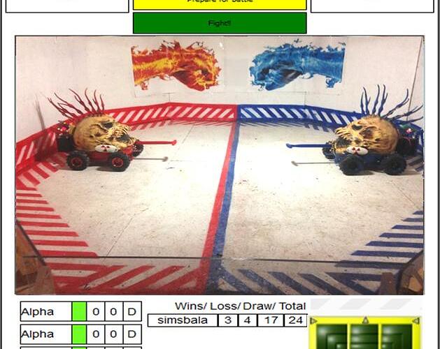

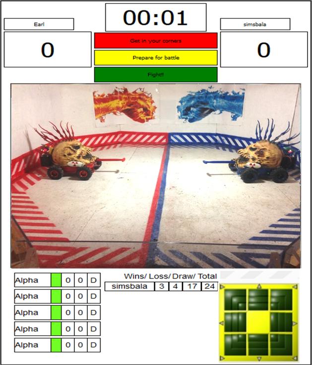

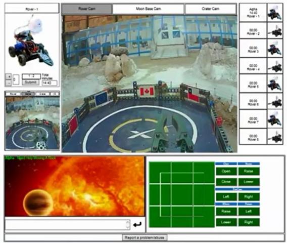

Well after being away many years ( building and programming of course) I’ve succeeded in connecting several robots to the internet using the Vex platform. I’m running 2 as online battlebots and 2 as moon rovers beside Shackleton crater.
These are the user interface I created to drive these things around.

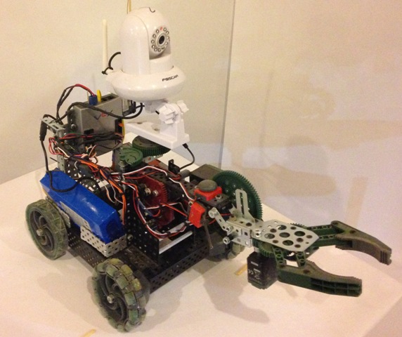

Here’s a close-up of ‘Explorer 1’ - Discovery class rover. I made it on the body of the original Vexplorer. Controller, motor, cam was upgraded.

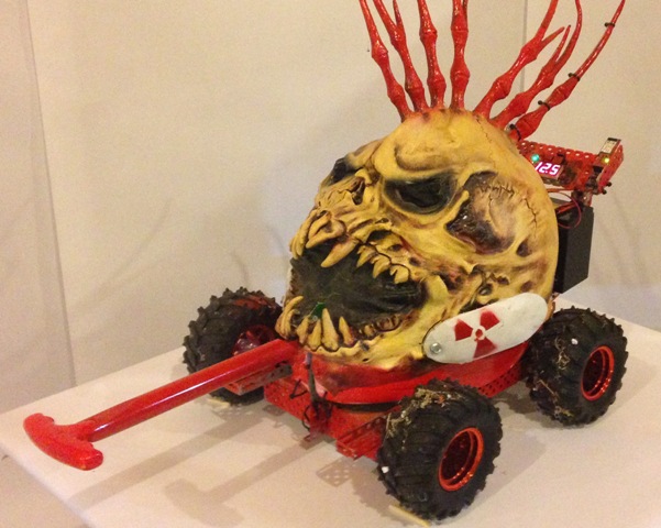

Next is ‘Kilo-Red’ - Cruiser class Battlebot. simpler to make. I use an arduino product to report the score back to the server. It used to have a 2-6kilo solenoids on a catapult. It proved to be too hard to manage. I would lose half the flipping power because the bot’s suspension would absorb it - gone. It’s another Vexplorer with a Halloween mask on.

I’ve made a few changes and the site is currently free to use. Come and check it out and let me know how the vex interface works.
Forgot link… centauri-odyssey.com
