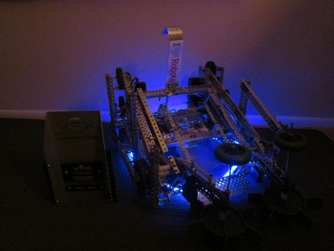

Introducing 2880A Torbots
Hello, we figured it was time for a reveal after this past weekend so here it is, enjoy.
Specs:
4 motor High Speed All Omni drive
2 motor Adaptive Intake
4 Motor high speed lift (5:1)
Pneumatic assisted lift/hang
Specials:
5 second Hangs (with ball)
Spits Bucky’s very far across bump
Defensive

Future Changes:
Faster Lift
Better Lock
Better Outake
Hold two big balls

Oh my god that hang was fast.
It’s because we have pneumatics and reverse rubber bands. The cool part is that when the pistons extend to help the lift it counteracts the pulling force of the bands

The lift motors are on high speed?
The ratio says 1:5, so I do not think they are internally geared for speed.
In response to TVEX’s question I felt that this match was showing the best attributes of our bot in a showcase way. if you like I could message you a video where the blue bot’s weren’t stalled, and we did everything the exact same way except that blued actually scored. Please don’t be offended by this response.
In response to the gearing, no it was not geared for speed. Through our own static tests we say that gearing up a high speed motor had less of a stall torque than vice versa.

Would you mind sharing how many pistons you use to assist the hang?
Looking forward to the release
We have since focused more on launching than hanging, considering that people were able to hang without the use of pneumatics, such as your robot. The pistons were double action, and we had rubber bands pulling down. Word of wise: Don’t reverse rubber band, you will overheat your motors so quick, and you possibly could even break the motor itself. The pneumatic we’re tricky to tweak, and after 3 competitions we finally had gotten it to work. We saw that more and more robots were able to hang without pneumatics, so we decided to make a launcher for San Antonio. We built our San Antonio bot in 3 days, and it performed we’ll, but not to our standards.
