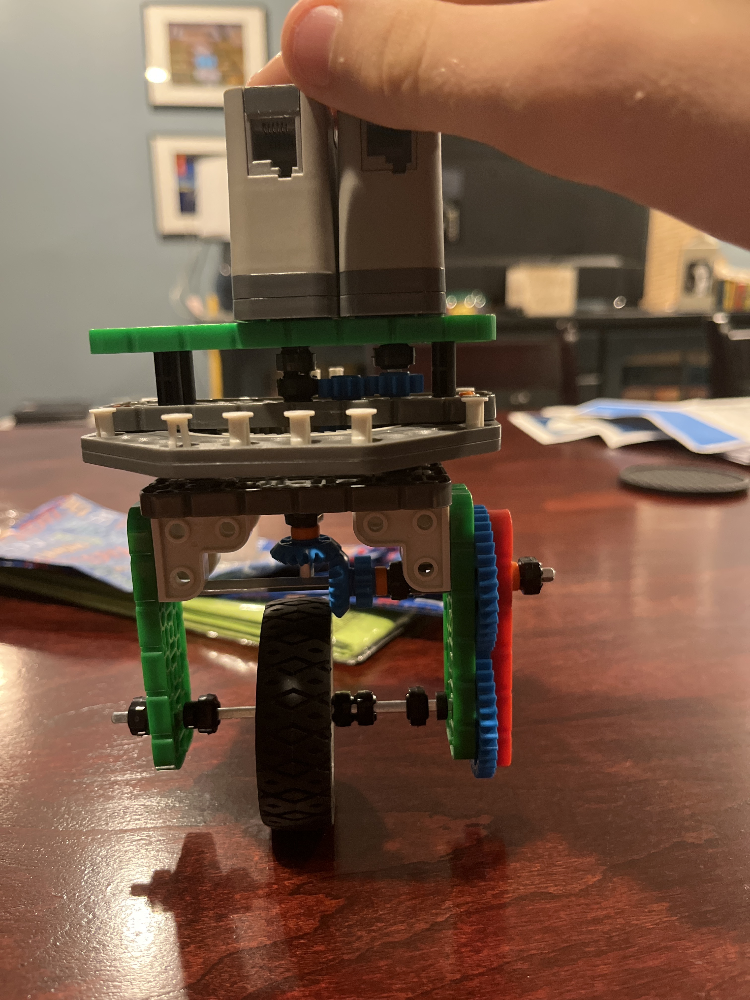

Like this? Welcome to my seventh grade lockdown project :slight_smile: I had 4 built, but have since scrapped all but one, too keep as a memento. Certainly not the best design, due to the awkward gearing to power the wheels, but still fully functional. Don’t have videos of it driving, since the programming was not a challenge I wanted to tackle; I didn’t know all of the requisite math. But it does work! Unfortunately, the 8 motors required for swerve to function makes it completely illegal in VIQC, but it is a fun idea to think about! Feel free to ask design questions, if you want.
Connecting the modules with chain like that is called Crab Drive in the FRC world and was swerve’s predecessor. It would cut down on wattage, but since each module has a lot of scrub when turning I would be worried it might not be enough power. Crab Drive also limits the maneuverability, and modern swerve code actually does have modules acting independently on occasion.

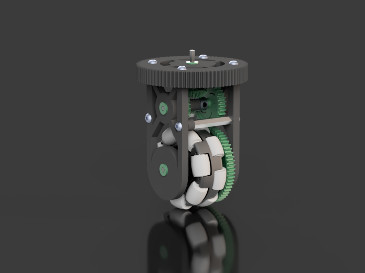

Fun cad project I did a few years ago. This was before the addition of new gears, so I’m sure the height could be shrunken down quite a bit, making it more viable.
Indeed it has.
Swerve with mecanum wheels on it. Interesting choice, now the software needs to make sure the wheels are oriented correctly for it to be able to translate.

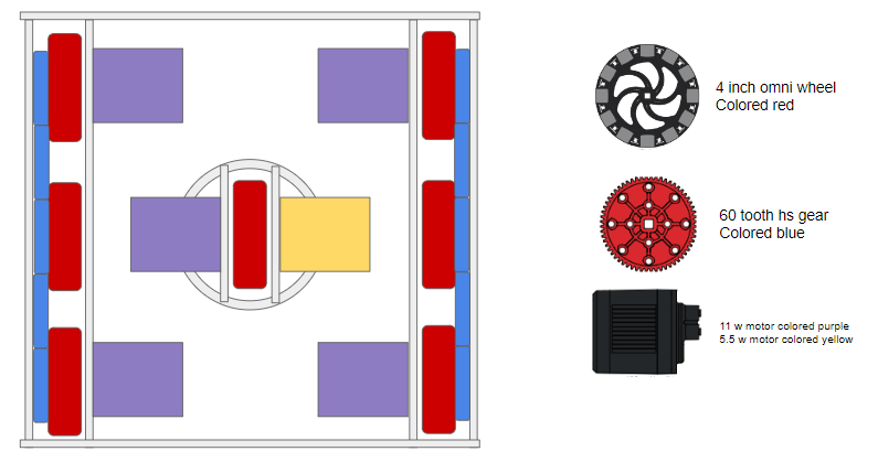

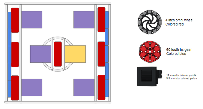

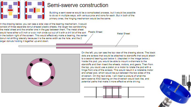

I had designed a swerve drive myself a while back. More of a semi-swerve than a swerve drive, it would function roughly like a swerve drive but be more realistic to construct. Heres some pics:
I would like to add a couple of notes…
First, having dual traction wheels on the same axle will create significant resistance against turning (changing the direction that pod is facing). One or both wheels will have to slip. This could be addressed by adding a differential, just like it’s done in cars.
As for the second example, you have to consider that the tractive force contributed by each wheel is limited by the weight supported by that wheel. If the weight of the robot is distributed unevenly then some of the motors will not be able to contribute their full power towards the driving task.
In omni-wheel based tank drives, where motors on each side are mechanically interconnected by gears or chain, if one of the wheels loses contact with the ground then the power from all motors on that side of the drivetrain naturally flows to the wheel(s) that still have the contact, so no power potential is wasted.
