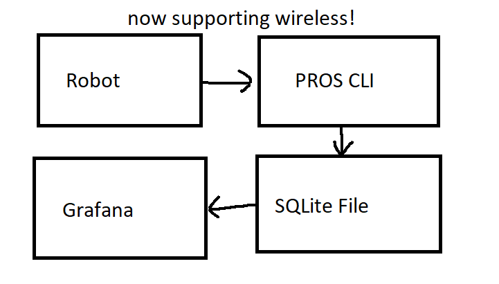

Current System
Current System
One of the largest issues of the previous iterations was having to manually program the visualizations. The absolute positioning display alone took over 400 lines of code after a bunch of abstraction, making it less than ideal to continue adding more ways to show data.
This is where Grafana comes in. Grafana is an industry tool for visualizing data that already comes prepared with charts, gauges, bars, and a bunch of other neat gadgets that lessens the amount I have to program substantially. It became clear that Grafana was needed in the workflow, and so the process changed, this time not only ditching the C# pipeline but allowing persistent storage:
Data Storage
An important factor in gathering data about your robot is having as much of it as possible. The default interval for these packets of data to be sent to your computer is 20ms, meaning 50 packets of information are sent within a second. For a traditional .txt or .csv file, querying thousands upon thousands of rows of data will suffer greatly performance-wise, requiring a more efficient solution: SQL.
SQL is a common querying language mostly used in MySQL or PostgreSQL databases. While these are performant and are great for massive companies or server racks, they are inconvenient to setup on a home computer and are a bit overkill for what would be stored in this scenario. Thankfully, SQLite keeps a lot of the performance benefits of SQL while remaining a single .sqlite file, something that requires no infrastructure whatsoever.
As the custom CLI receives data from the brain, it is then piped into this SQLite in the form of a table, where it contains the various attributes being tracked by the program while also recording the time the data was sent. This is crucial, as otherwise Grafana wouldn’t know where to the points on a time series. An example of this format can be seen here:
This data is then read by Grafana automatically and made available to the end-user, where they can then arrange charts in whatever fashion they’d like.
