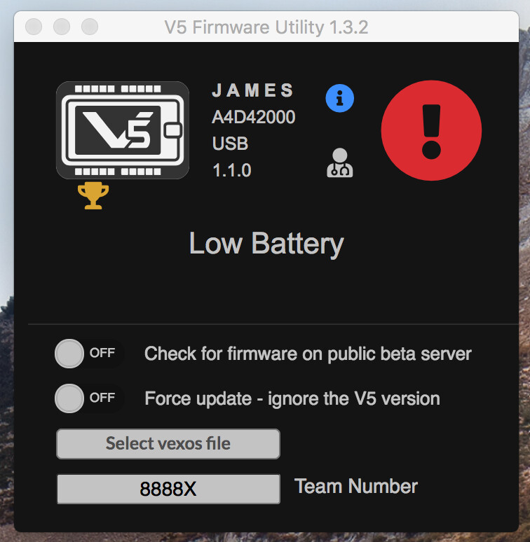

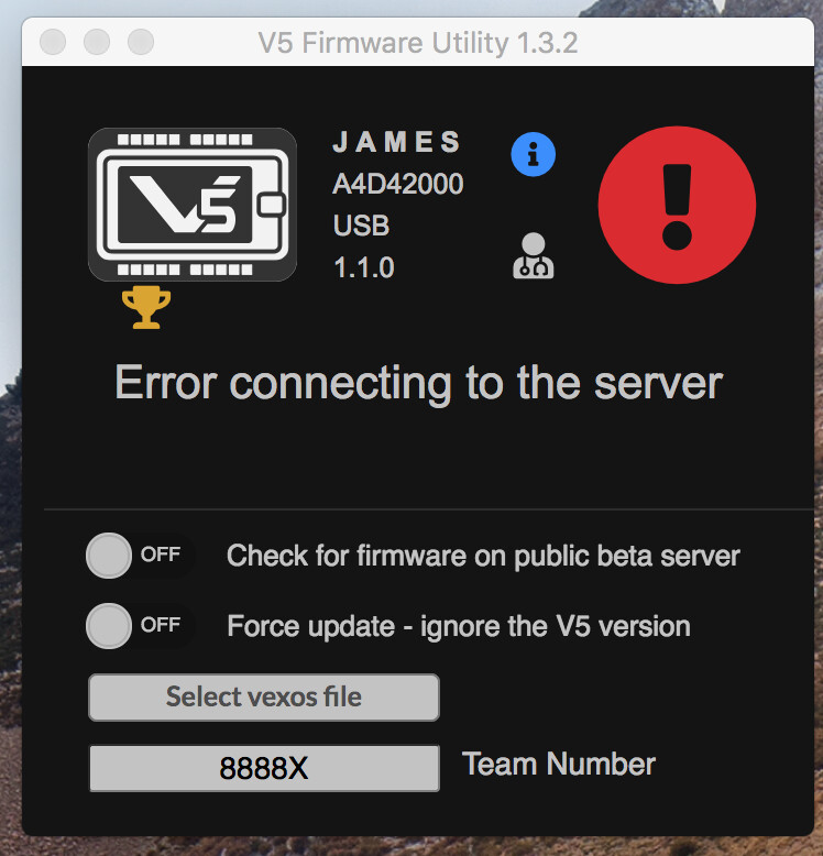

Red exclamation mark can only happen for a couple of reasons, usually a network issue, the updater cannot get to the vex server and cannot determine that the network is offline, or a low battery situation on the brain. In both cases there should be an additional error message, see below.
Is the brain serial number and version shown ?
Perhaps verify the firmware updater can connect to a working brain and not show any exclamation marks.
