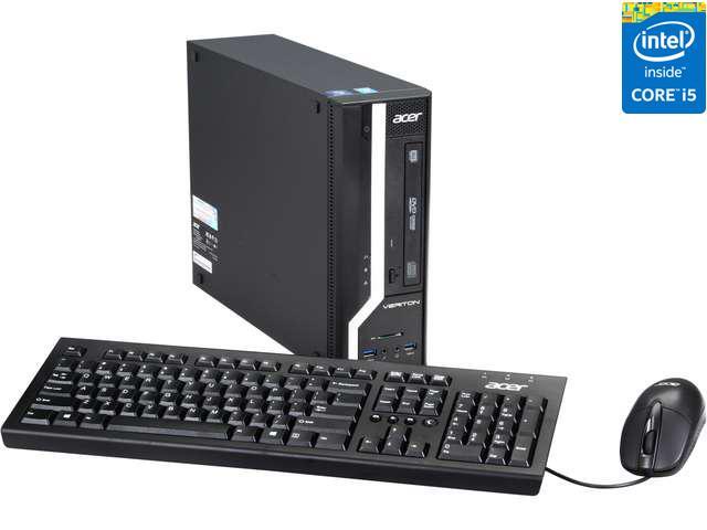

What are the specs of the computer you’re running Autodesk on?
Ok could very definitely be wrong on this but I believe it’s:
I think it might be the computer now that I’ve looked into it…
Considering I have an i5 2.4Ghz, 6 gigs of RAM, and an Intel HD 3000 integrated graphics card, and Inventor 2013 gets incredibly laggy with me at times, you’re probably right. You could try lowering your graphics settings in Inventor and see if it fixes your crashing.

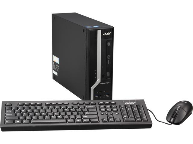

After talking with my teacher, I’ve found they have i5 processors, so I think it’s this bundle:
And it isn’t my computer so all I can try to do is lower settings or pass on info to the IT to fix a bug.
