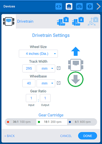

our robot code is C++ however it could go forward and backward perfectly fine but when turning left or right it is inverted, we tried switching motor ports, but we believe there might be a problem in the code… any ideas to fix it?
Well, we kind of need to see your code in order to tell you what is wrong with it.
First, try switching the motor ports (all of them).
If it’s a further issue with the code, you need to show us the code.
If you are using the default Drivetrain, it may be as easy as flipping the robot direction.
