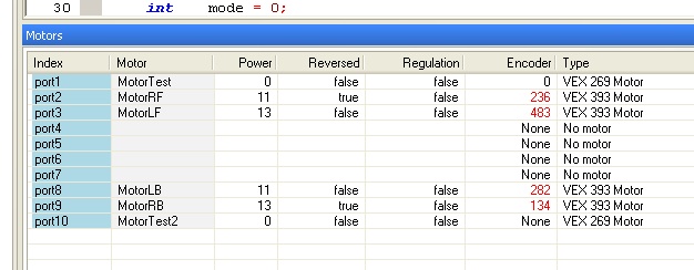

Here is the debug window from a four motor drive (ignore the two 269s).
[ATTACH]6832[/ATTACH]
Left hand motors are not reversed and rotate counter clockwise if viewed down the axle. Right hand motors are reversed. All motors are encoded and the encoder count increases with positive command values. The encoder count always starts from 0 so if driven backwards the all the encoder counts will decrease and show as negative. If the robot was turned clockwise then left hand encoders would increase and right hand decrease.

Forgive me but I’m not seeing this. When the left motor is not reversed & the right motor is reversed in the Motor & Sensors dialog box with the encoder checked off & I2C selected, when we run positive command values our right encoder shows negative values in the debug window & the left shows positive. Yet the motors move forward as though both received positive commands. On turning left, both encoders show negative values & on turning right both show positive values. It appears as though the debug window is showing raw data but somehow the “nMotorEncoder” function is internally flipping the negative values to positive because it knows the motor was reversed in the Motor & Sensor set up. All of our forward, reverse, turn functions work as though the reversed motor encoder is going positive when there is a positive command value even if the debug window shows a negative value.
Ok, lets back up one step. Which version of ROBOTC do you have installed? V3.51 is the latest release and is what I’ve been using lately. Are any motors in the 2-wire ports? It’s possible to get the behavior you describe from those but I though you were using MC29s.
EDIT:
Another thought. Are you looking in the “sensors” debug window or the “Motors” debug window. The motors window will show the value of nMotorEncoder, the sensors window will show the raw, non-inverted value. Reading the encoder using SensorValue gives raw data.
I’m using RobotC vs 3.51. But you are right. I’m using the 3 wire ports with the Motor Controller. I was looking at the Sensor Debug window. Never occurred to me to check the Motor Debug window. Thanks for the explanation. Will check it tomorrow at school.
