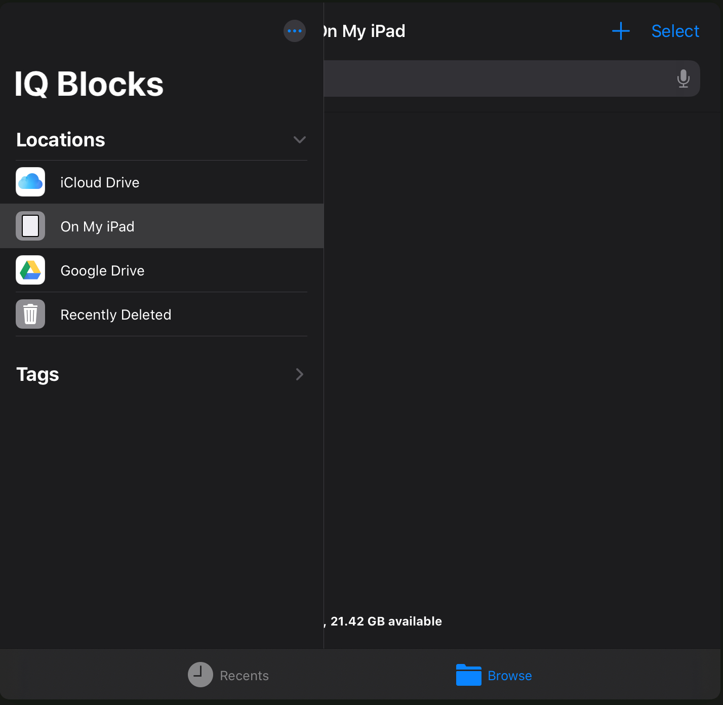

You can save IQ blocks projects on iOS to any could service supported by the Files app, including Google Drive, Dropbox, MS Onedrive, and various others. If your school uses one of those services then you could set up a shared folder accessible from all the iPads and keep everyone’s code in there.
I see that I can upload them to Google Drive from the Google Drive app but is there a way to do it directly from the IQ Blocks app?
Yes. Google Drive should show up as a location in the file picker that appears when you save a program.
Once Google Drive is installed on the iPad, you should have the option to add it to the Locations in the Save As dialog box.

I was able to find the option to save to Drive but when I create the file in IQ Blocks, it doesn’t actually let me save it. There’s no save button to click on. It just lets me create and name the file but to actually get out of the save menu, I have to save it to the device.
