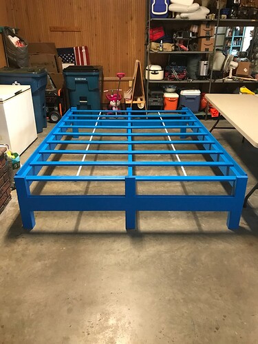

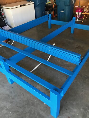

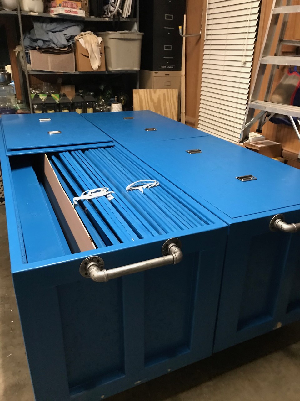

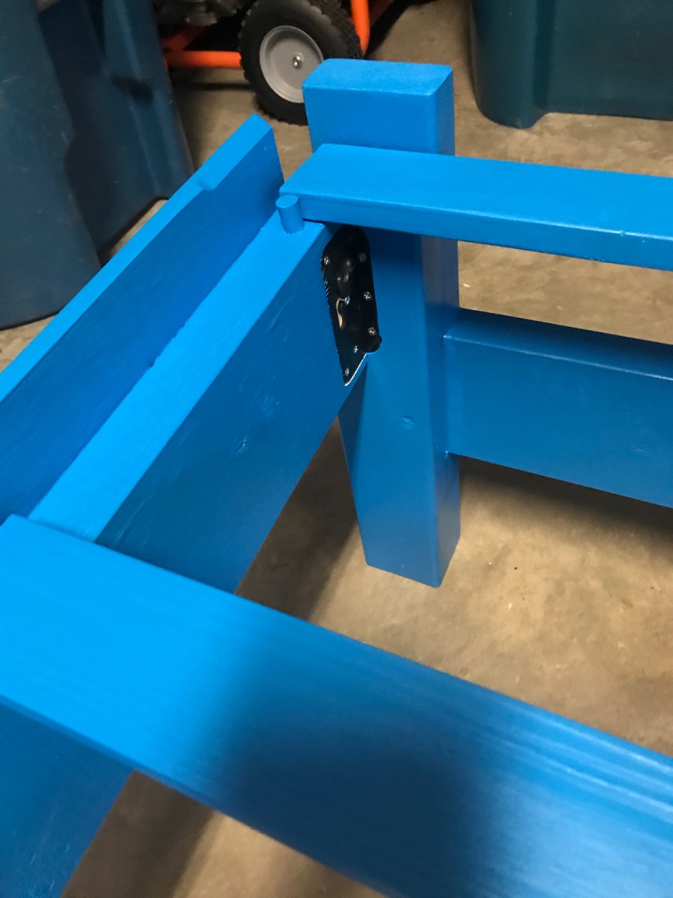

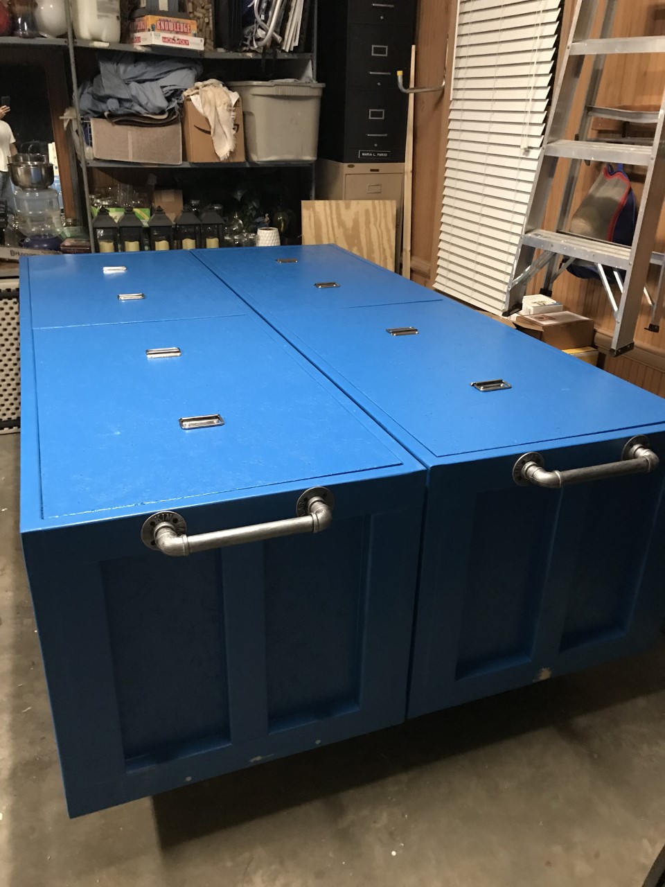

With the new field dimensions and running 4 field events, coming up with something other than 8’ folding tables became a priority. Each transport hold 4 field risers. 18" height. Here’s my final results.

Very very very nice. How much does one of the carts weigh with the field tiles and the slats?
This is awesome. Particularly like the way that the Field is captive so it can’t slide around. Top job!

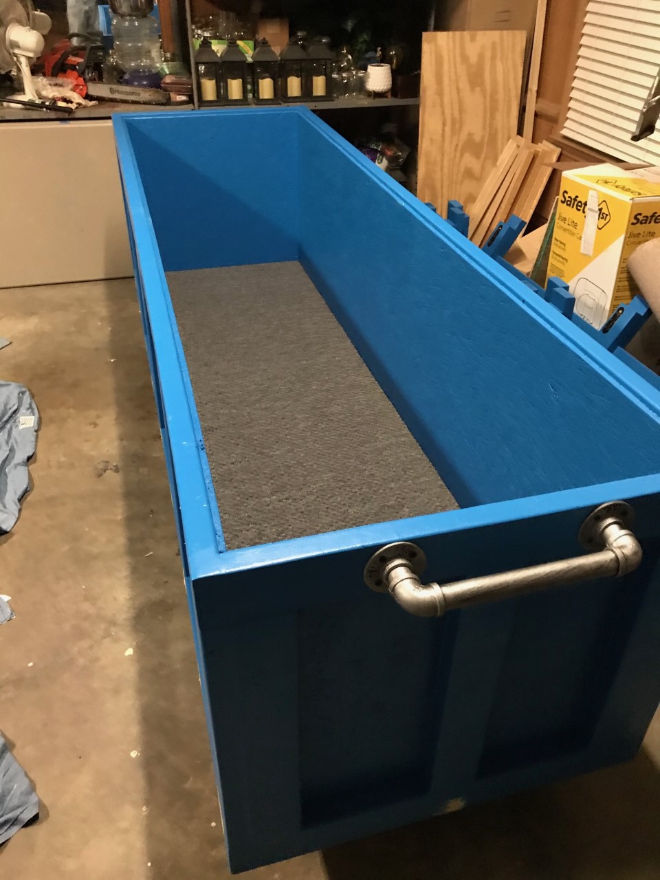

Each transport holds four field risers. Total weight of one transport and the four risers is 825lbs. I’ll be using a 12v 2000lb. winch to assist rolling up ramp into trailer.

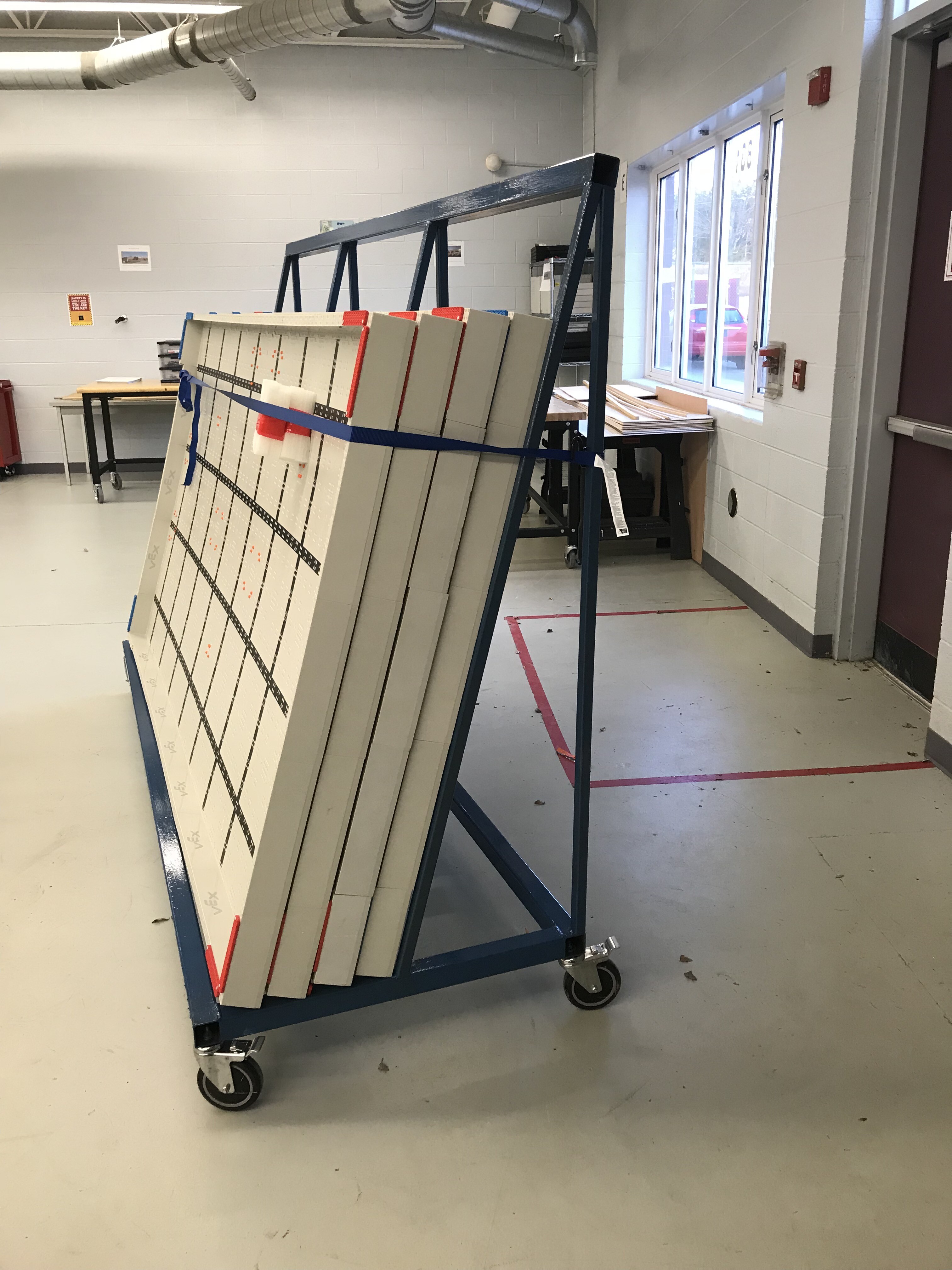

I’m looking for an efficient way to transport four fields. This is what we used prior to the field size changing.

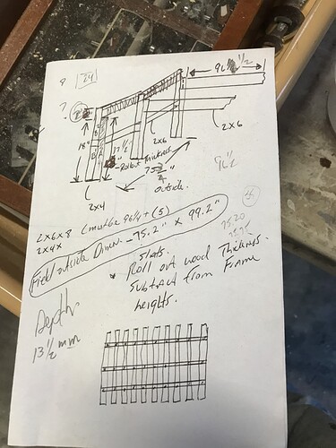

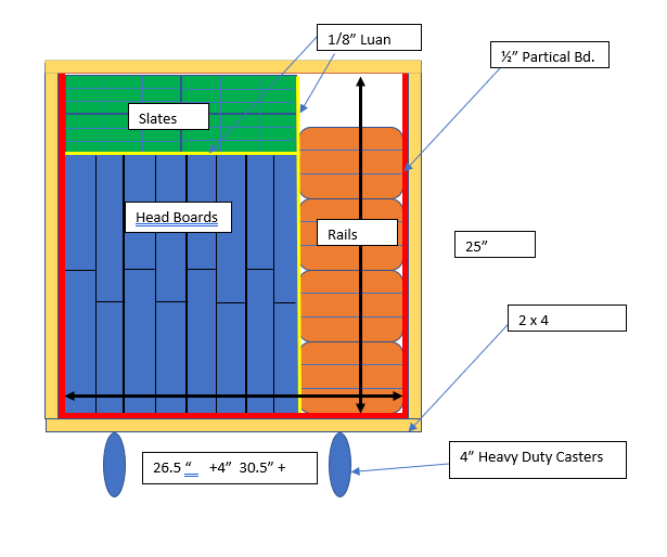

Here’s what I have for the risers. The sketches for the transports have been erased from my classroom whiteboard. I do have the illustration I did when figuring out how to pack the transports. My inside dimensions of the transports are: 28"W x 26"H x 100"L
Casters are rated for 1500lbs.
