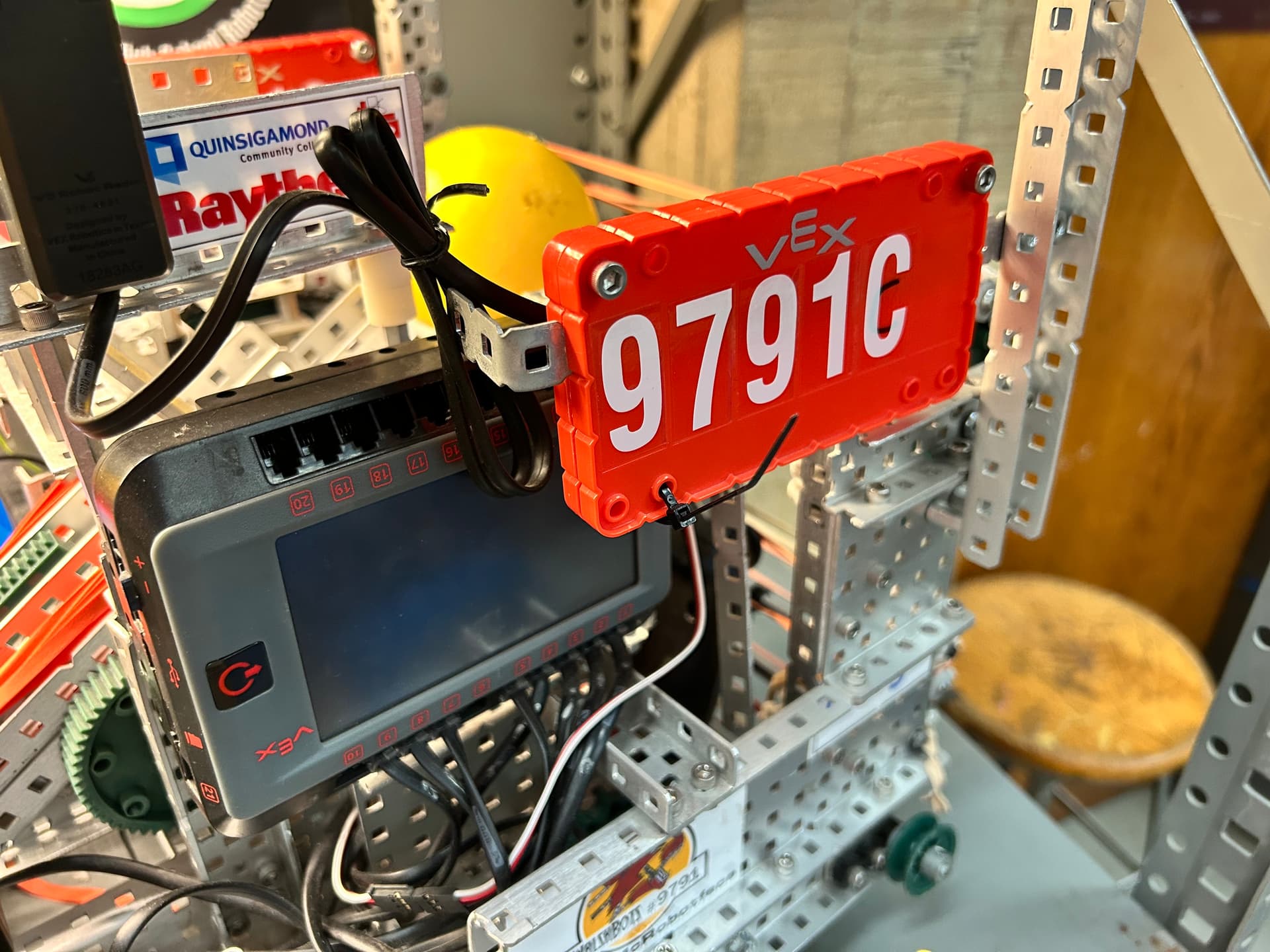

I think the IQ bin bans are so silly. I don’t have the time to use screws and I don’t want to waste zip ties. Thoughts?
Sadly I’m thinking that this is the road V5 is taking but rubber bands could be an option
Plates fall off too easily with IQ Pins - I suspect Referees were getting tired of mis colored teams on field.
As for quick swap - wouldn’t a one bar sandwiched between two plates work for you? It has for teams in our club for many seasons now.
There are other solutions.
Thanks, I will try that
Here is an example used in Turning Point (even though there is a zip tie, it is not necessary - solid mount.:
You can have two screws mounted to structure with nylocks with an extra half inch of screw protruding as posts to slide a plate on to. Add hand-tightened wing or keps nuts if desired.
