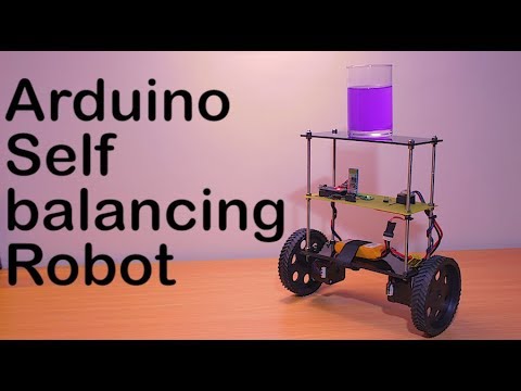

i think 1 wheel per side is good enuf
Riiiiight… I’d like to see that in action.
Well… Its possible.
