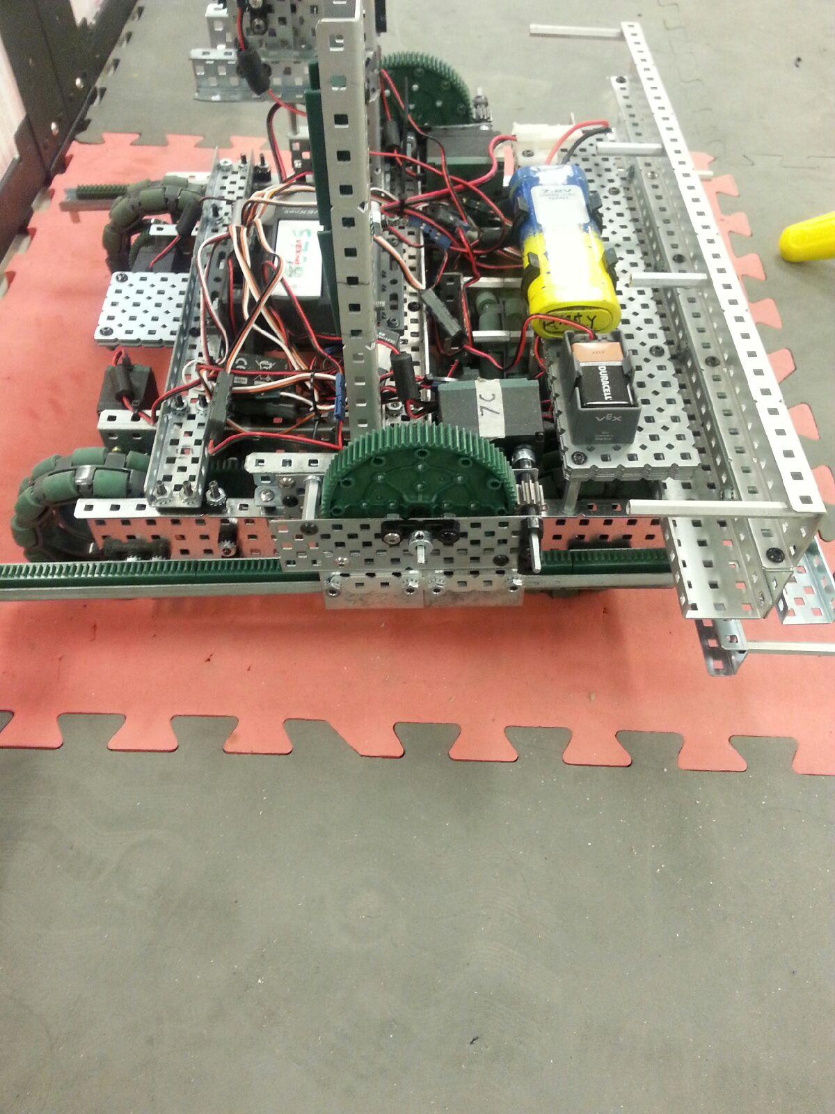

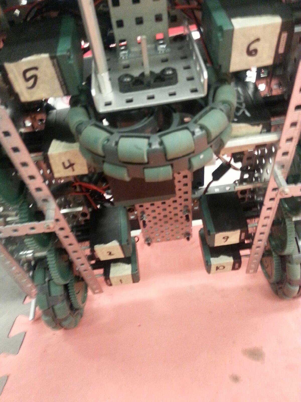

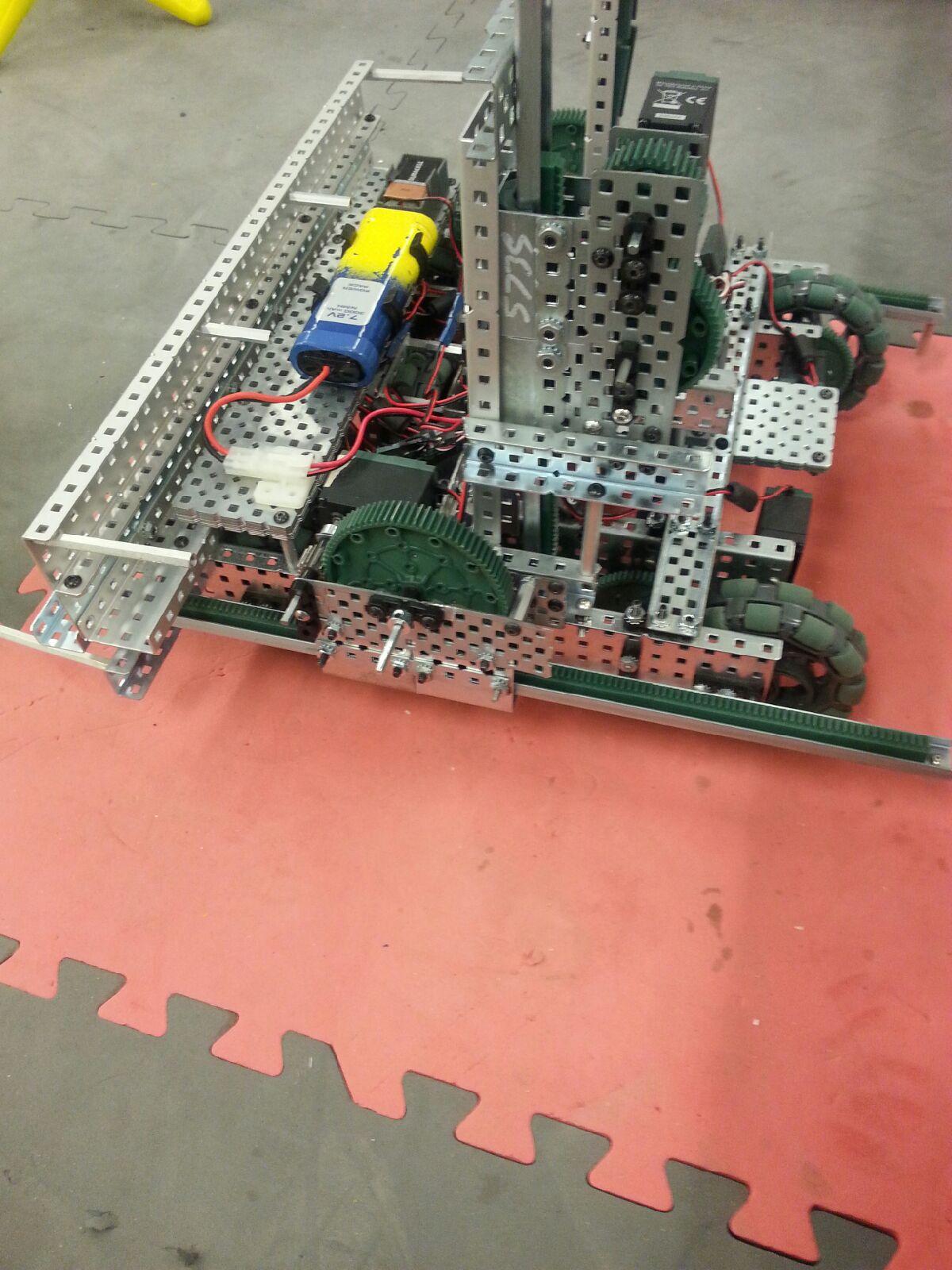

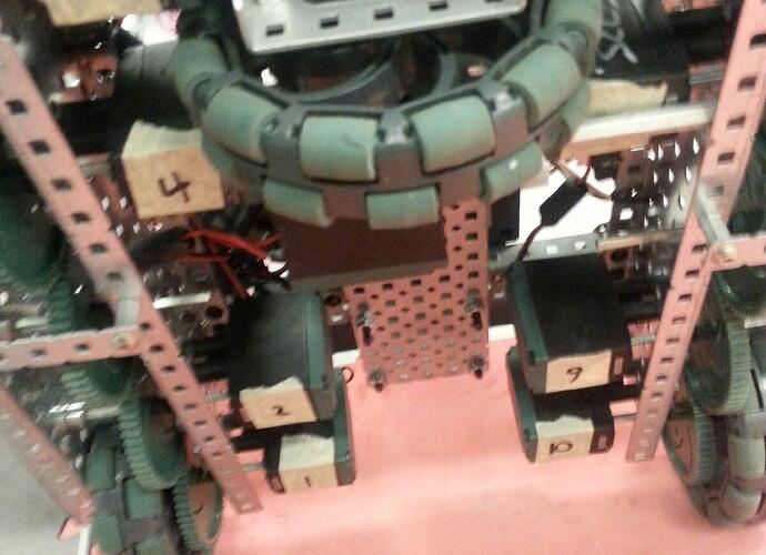

Can you post a picture of your robot? Many teams are using the motors for the arm to also power the hang. You may not need to change the motor configuration, but just add something simple to the structure.
@Elohssa We have an 8 motor drive, 1 motor for an H-drive, 1 motor for an arm to knock stars off of the fence, and 2 motor for a plate that extends forwards to help push the scoring objects under. We talked about taking the “star knocker” motor and using it for a hang instead.
Because I was curious, I held onto the extending plate while retracting it, and I was able to get the robot to lift; however, when I stopped retracting it, it stared to lower itself because of the weight. Both of the motors for the front plate extension uses a 1:7. So, I’m thinking a possibility for the gear ratio (assuming we don’t winch it) would be somewhere around a 1:49. I was, however recommended a 1:25 which I don’t see working.

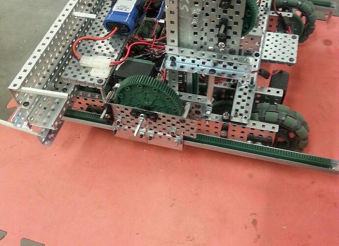

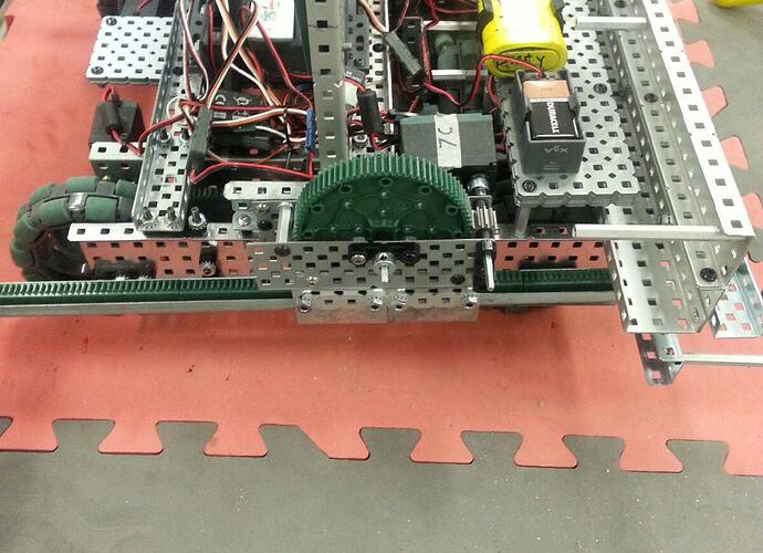

This was our robot in June. It had a one motor 1:1 rack and pinion design (our Y team used two motors), and it could lift and hold all 6(ish) pounds of our robot.
