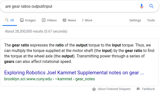

When measuring torque you calculate output teeth / input teeth.
That actually depends on who you ask on this forum. We still haven’t come to a final conclusion :stuck_out_tongue:
Edit: True for calculating torque. But when asked how a gear ratio is written, the forum users are divided
I always put my driver gear before my follower gear. so 1:7 would be 12 tooth gear as my driver, 84 tooth as my follower
Well…
I say 1:7 (input:output) because it makes more sense and sounds better but…
It’s technically output:input
always trust dr.google
11%20PM
This is not the best approach, because while most properties of a gear ratio are measured as out/in, speed is measured as in/out, so using one format could be confusing.
https://www.smlease.com/entries/mechanism/gear-train-gear-ratio-torque-and-speed-calculation/
