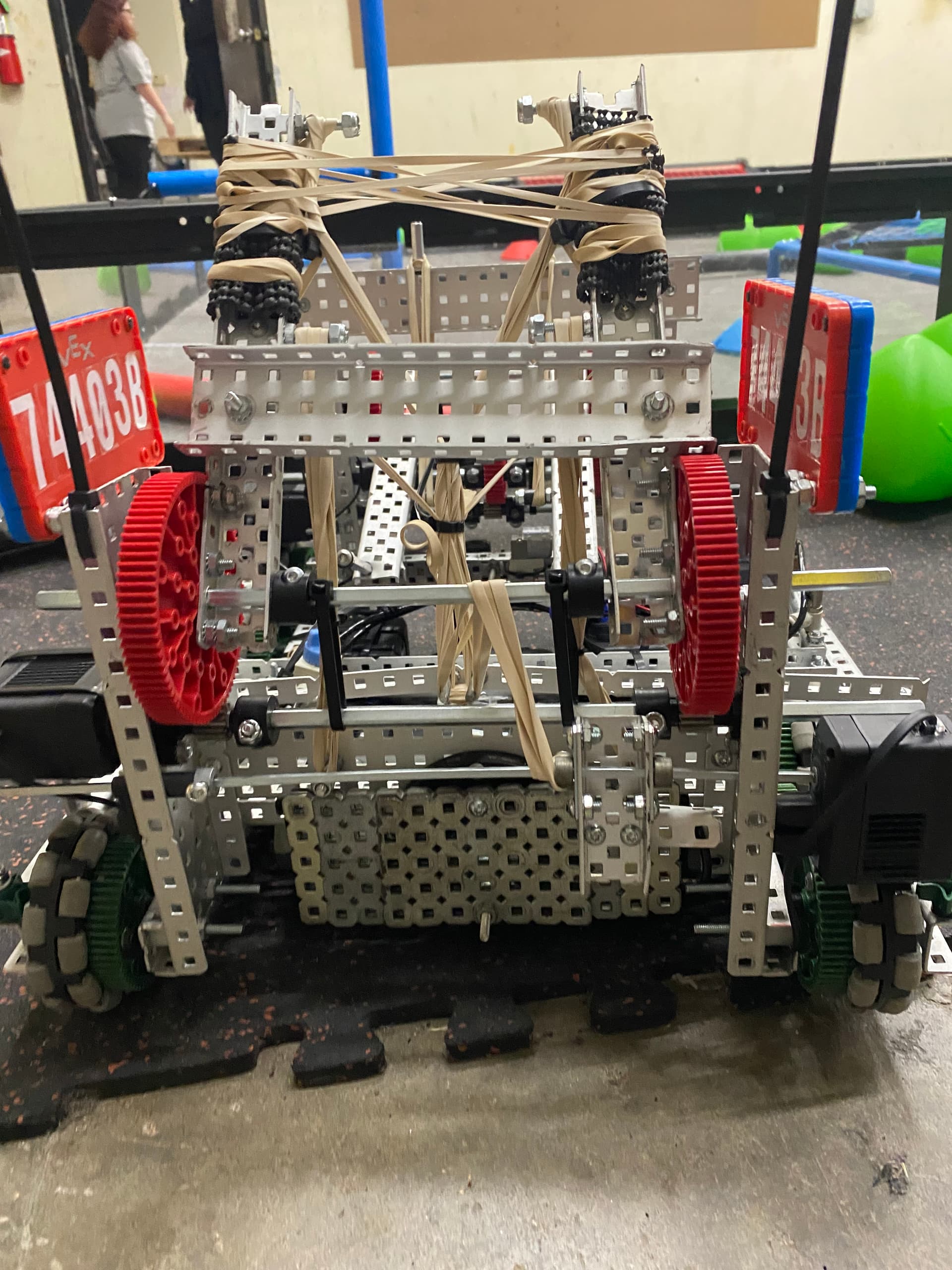

i would say a slapper it hits the balls off really fast and depending on the banding you have on how far it would go. if you don’t want to get blocked. then put it on a double reverse four bar then you can shoot from high where you cant get blocked. And if you want to you can put a standoff on it and and make it where you can climb from it too. I can give you a picture of my climb if you want it it gets a c to b tier each time works really good. it runs on a 100 rpm motor to climb and a 5.5 to lock it.
Yes, please, we are looking for some help with a hang mech
will you share a pic of your bot so i can see it.
Plz
OK let me get a puck on Monday we are not is school and i don’t have a pic of it. and i will have of video of it climbing if you want to see it.

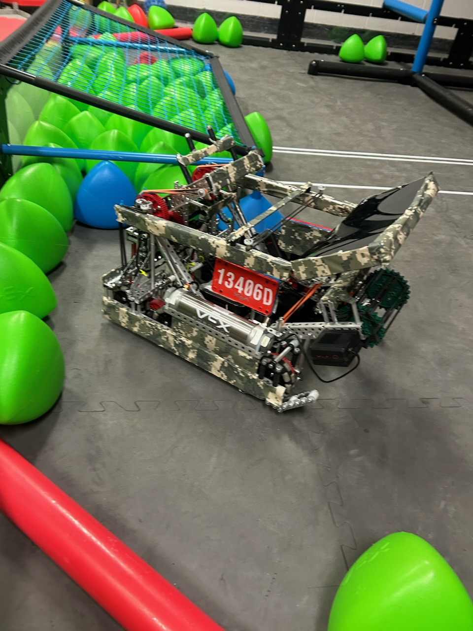

Sick camo. Assuming that is legally implemented under the restrictions of R8, that is AWESOME! I’m just using clear polycarb.
That looks a good robot.
Do you have a picture of your robot?
yes give me 30 mins cant send it to my compurter to my self
You running some 5.5 watt motors on there?
Yea, ours is 30 RPM with a single slip gear but we are planning on going to a double or triple slip to get us to the equivalent of 60 or 90 RPM

I think it is, we ended up taking it off because it was our first tournament and we didn’t need any warnings
yes we use a 5.5 for a locker.
