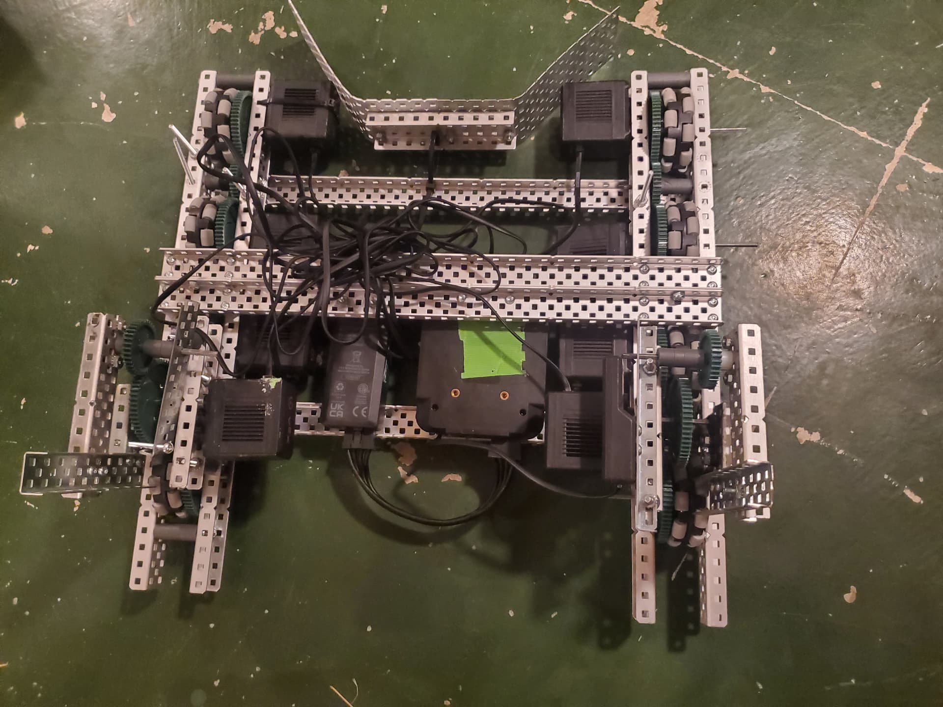

we just finished our version of the pto drive, it works great and even without any extra weight it can push our regionals robot, it also goes faster so you definitely could rush auton line, however, we are going for an easy winpoint.
Sounds great. Just wondering if you pto drive from 6-8 motors for example or is it a rpm switch Eg: 600rpm to 300rpm. And if so what ratio did you find works best?
we use 6-8, but the motors we are using for the intake will be geared up we think 32-tooth to 12-tooth, that is my teammate’s job so don’t take my word on it here are some photos, feel free to use any of the ideas.
