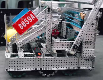

As the team that you used as an example (in the pic) - yes, it is very effective in countering being pushed from the side.
Traction wheels can give you similar effect, but traction wheels (if not mounted in the correct position) might give you problem when turning and also the diameter of traction wheels are not exactly the same as your omni-wheels.
If you want to look at the effectiveness of locked omni, just look for out 8059A matches during the Turning Point worlds :slight_smile:

Locked Omnis are very effective at countering being pushed from the side, but there is a second reason that they are so effective - Because locked omnis have a very small increase in radius compared to regular omnis, in bling drives, the center wheel slightly pushes into the chassis, which helps increase friction with the floor.

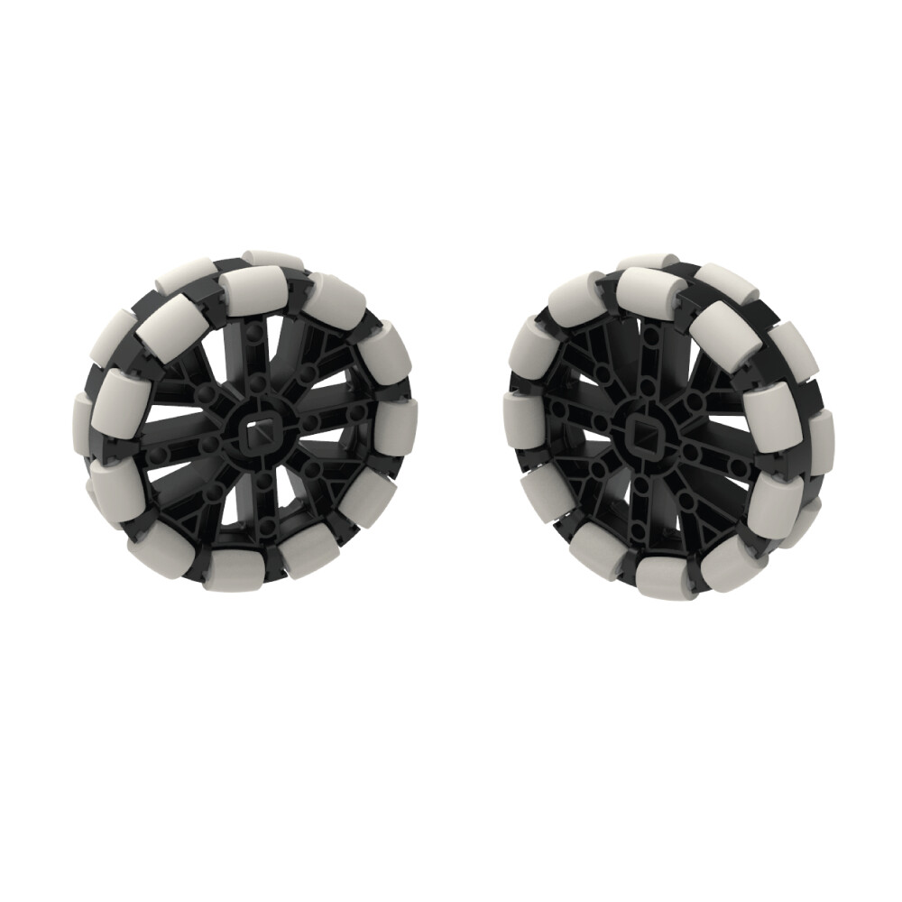

My students recently feedback that bling wheel is not the best option for the new omni wheels. - the screws caused the rollers to drop out easily.

I have used bling wheels before. There are plenty of alternative options now and a variety of wheels that can do the same thing that won’t permanently destroy the omni wheels entirely. I would highly suggest to consider alternatives unless absolutely necessary because once you turn omni wheels into bling wheels you cannot undo the damage on the rubber. Additionally, the small rollers have very thin rubber and will tear over time. Also, a screw may pop out and completely destroy your autonomous and perhaps driver control due to the wheel locking up. All of these things have happened to me before when I tried using bling wheels and I would strongly advise against using them and consider alternatives unless absolutely necessary.

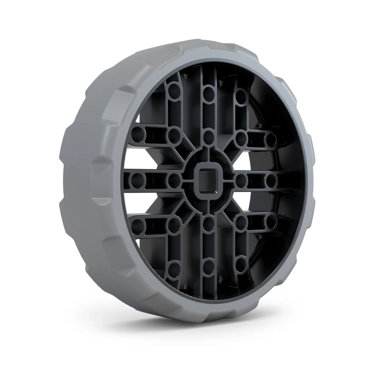

I have personally never used a ‘bling’ drive but, if you dont want to put screws into your precious omnis you can use traction wheels which work the same way. Here’s a picture and a link for ya:
Screenshot 2024-05-29 5.48.01 PM
You can also use a flexwheels for this.
Screenshot 2024-05-29 5.51.11 PM
Will this cause any issues with the middle wheel not contacting the ground? That was my main concern with traction wheels at first.

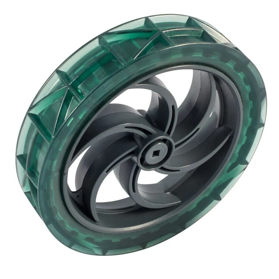

The new omni and traction wheels (grey, see below) have the same OD now, so this shouldn’t be a problem like it was with the old green wheels.
Ok, thanks so much! I’ll use those if I can get them.
No, it should not be a problem because the Omni’s and tractions come in the same diameters(2.75, 3.25, & 4.0 inch’s)
Yeah, my team only has really old traction wheels at the moment which seem to be slightly smaller than the 4 inch omni wheels.

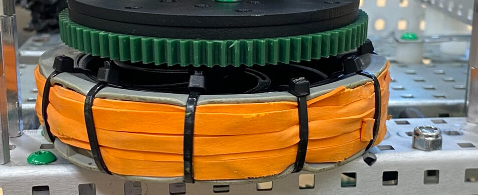

If you can’t afford to get new traction or omni wheels now, you can always experiment by adding lots of rubber bands or surgical tubing to existing traction wheels:
Who knows, maybe they’ll work good enough that you won’t need to buy any new expensive alternatives.

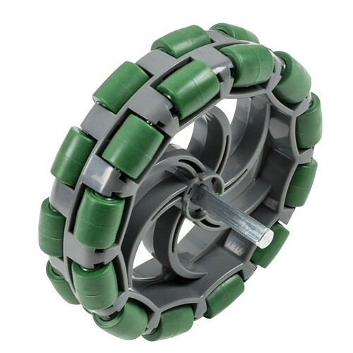

Do you happen to have the old omnis as well? If so, I believe those are 4.125 inches in diameter. Correct me if I’m wrong :face_with_monocle:
They say 4 inches, but they’re definitely larger than these, which is what we have:
