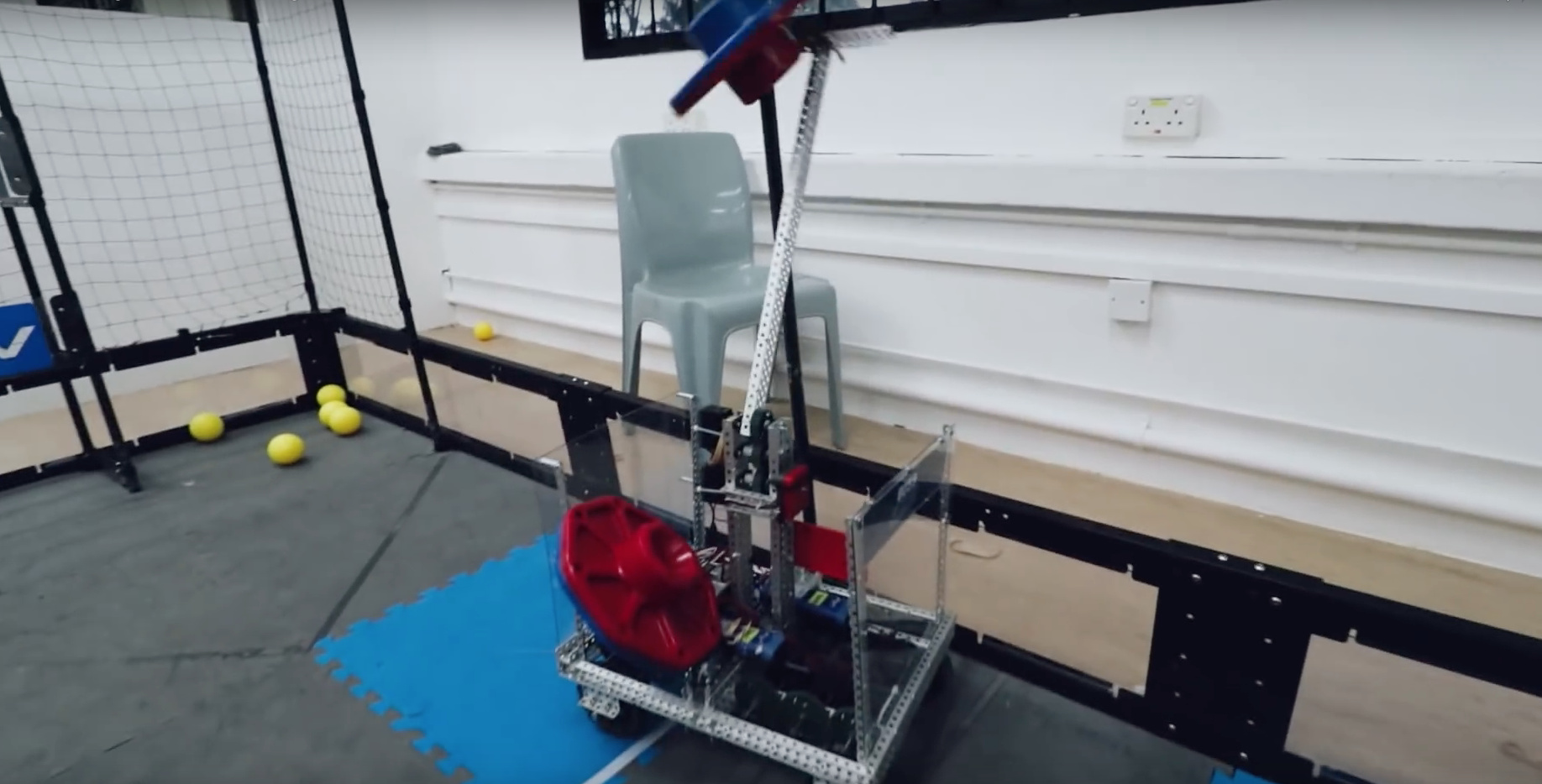

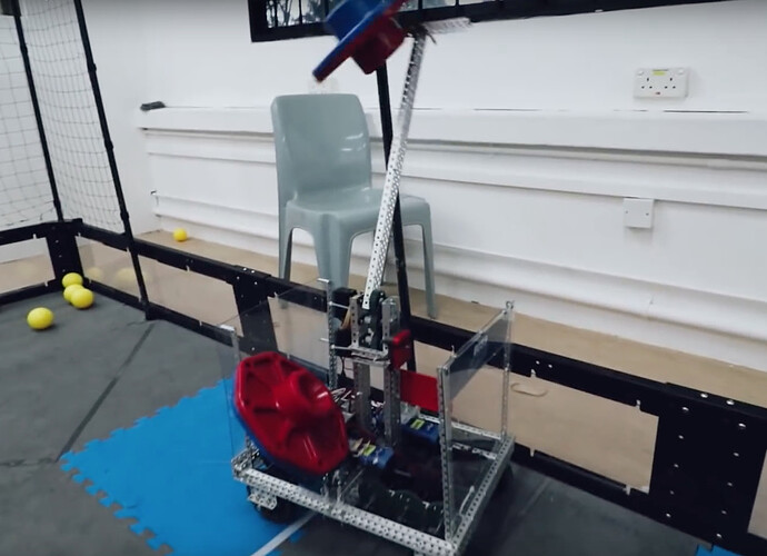

Single-bar descoring mechanisms almost definitely cannot get caps off the high posts, so you could lock up four points that way.
#20
Enclosed is a picture of 8059D’s robot. As you can see, their robot can knock a cap off of a high post.
