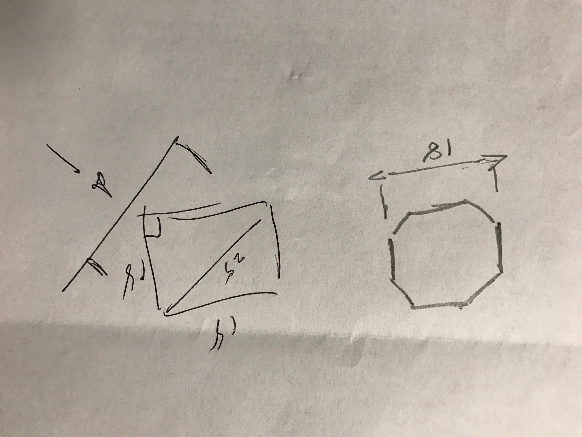

Related question. I have a team that created an octagonal chassis. At the first event it was called into question that it was not legal size. It is basically a 17" square with the corners knocked off. Is this not legal? I had a team 2 years ago with the same chassis type and it was never questioned. Similar to the one picture attached thanks!
If it can fit into a cube 18"x18"x18" it is meets the size requirements.
Thanks lacsap! They were actually using the sizing 18" tool |—| and trying to run it across via the corner slants. That would be like trying to run across the rectangle chassis at a diagonal or about 25" span.
I was going to add that a 8-1/2" x 11" sheet of paper’s diagonal is 14" but would fit in a 12x12 box …
