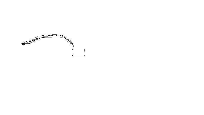

You mean like this?
I think thats legal.

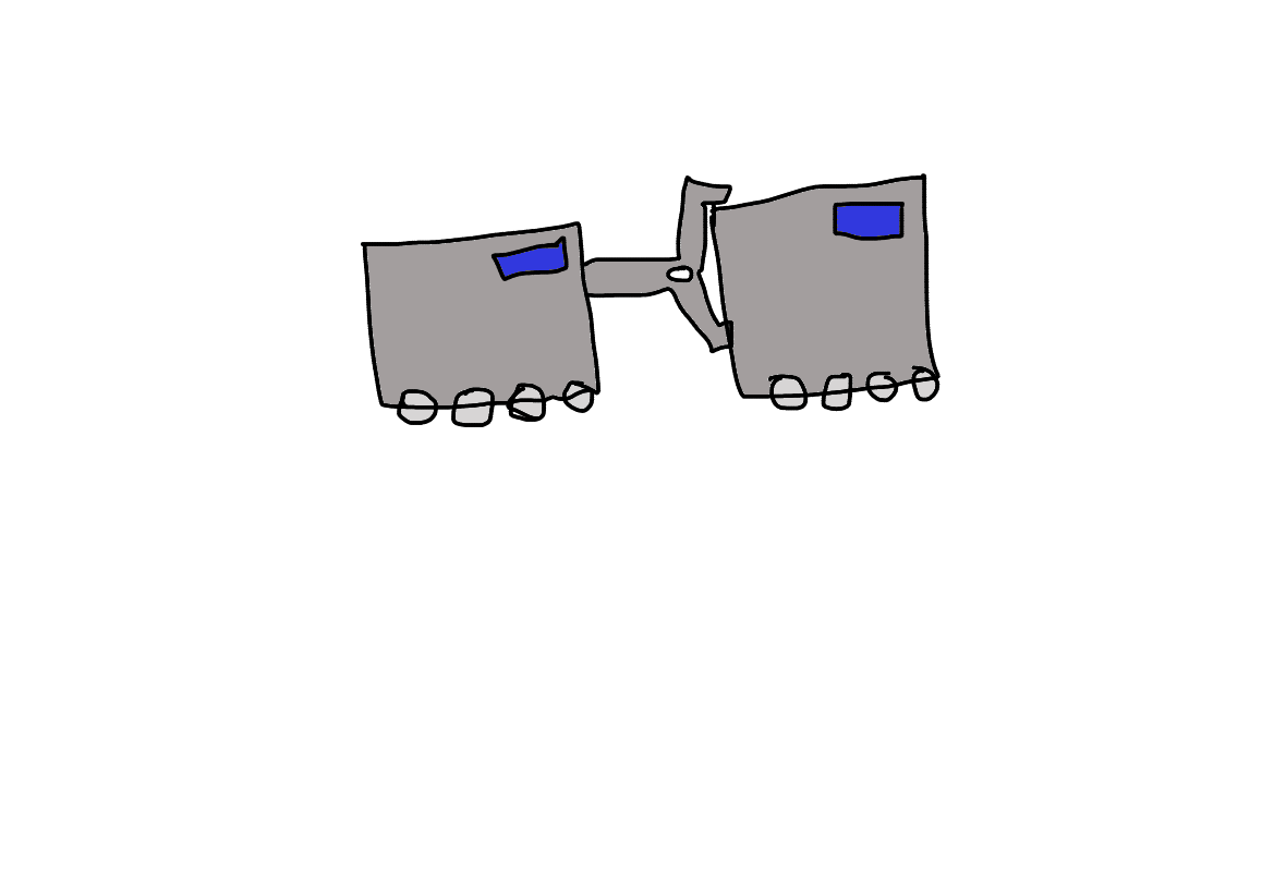

I mean like this (forgive the lousy drawing, I was trying to do it fast.)
yes that is legal. I honestly can’t think of a way to do double park without one that doesn’t depend on a good alliance. My team is definitely having one, only question is if it’ll be pneumatic or a halfmotor with a pretty serious torque ratio. depends on what concept we go with for output.

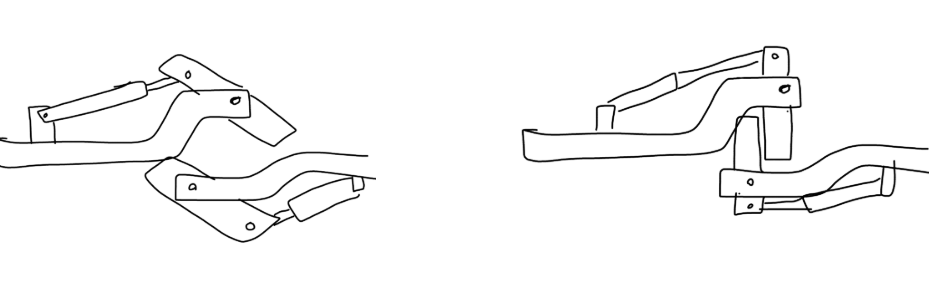

What type of interlocking mechanism are you thinking of? It would be a little weird because it would need to attach to a mirror image if itself and also similar designs. A train hitch style knuckle mechanism is an option.
Keep in mind this is a preliminary design sketch and probably won’t work, it is only a visual to illustrate what I am thinking.

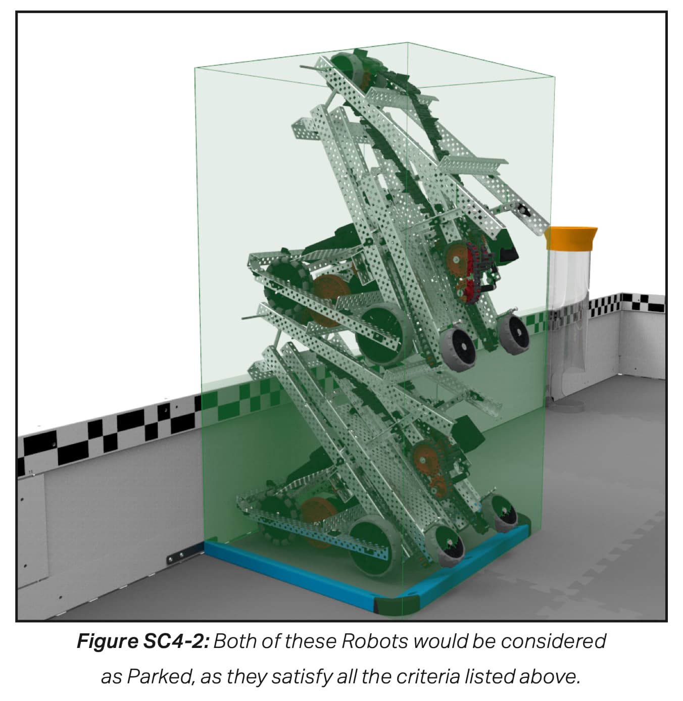

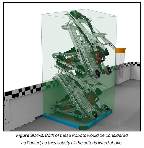

Currently, according to the manual, stacking robots, despite being actually shown in the manual as legal, breaks the expansion rule, since it is not measured from the bottom of the robot, it is measured from the field flooring, so if your robot is elevated so the top of it is over 22" above the floor, that is not legal

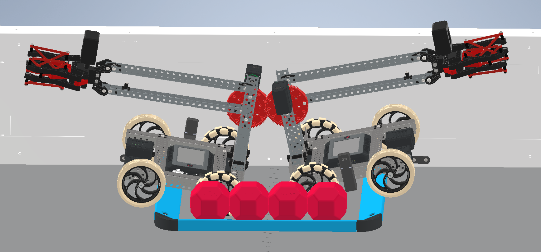

I was thinking something like this:
basically just have a standardly placed C-Channel, or maybe a C channel with a square, and on the opposite side have your active mechanism.
this way, if you have a not very good alliance during quals, you can bring a couple that can just screw on in a minute, that way you can get buddy climb no matter what. Also, allows more creativity in design.
and this also means that if one alliance Members lifter breaks, they can tell their partner, and have their partner do the powered lift, while they do passive.

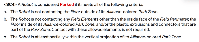

Thought I should post this into one of the threads discussing dual parking…

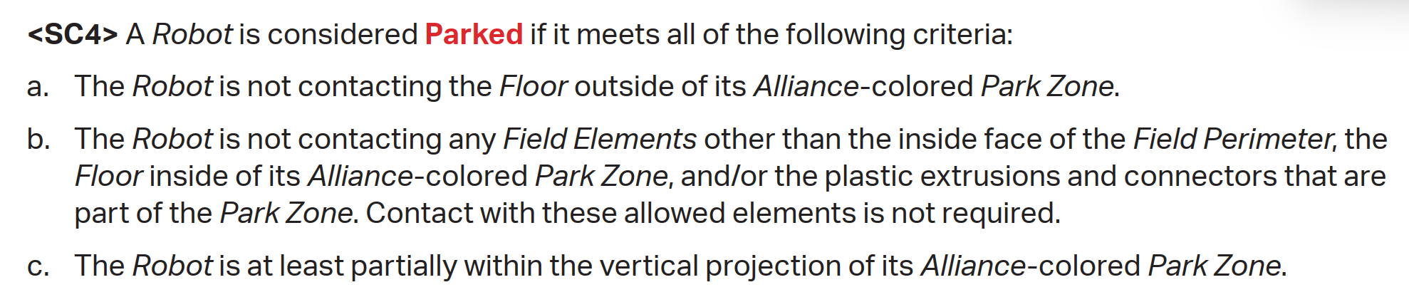

The reveal video showed two stacked robots and I think that is misleading some people. There is a much simpler way to dual park.
This satisfies SC4 as it is currently written.
