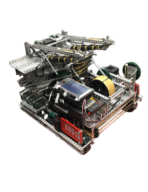

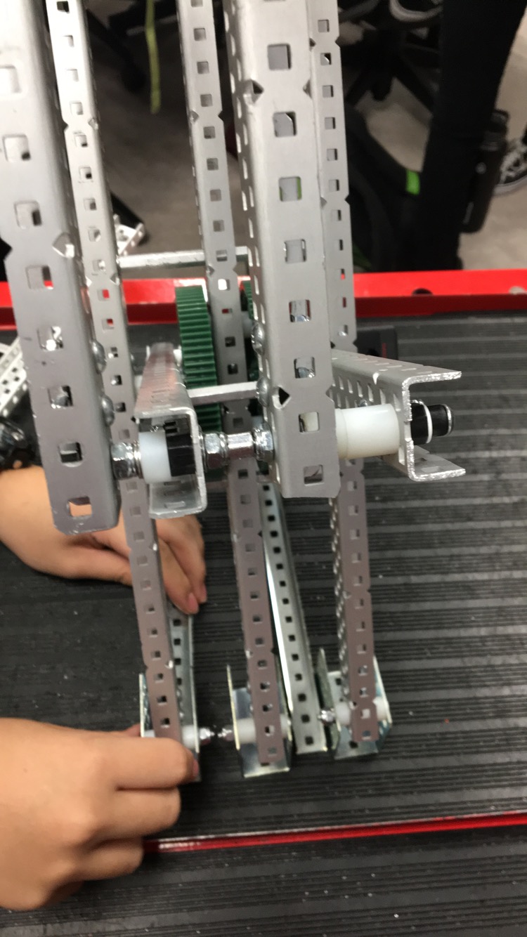

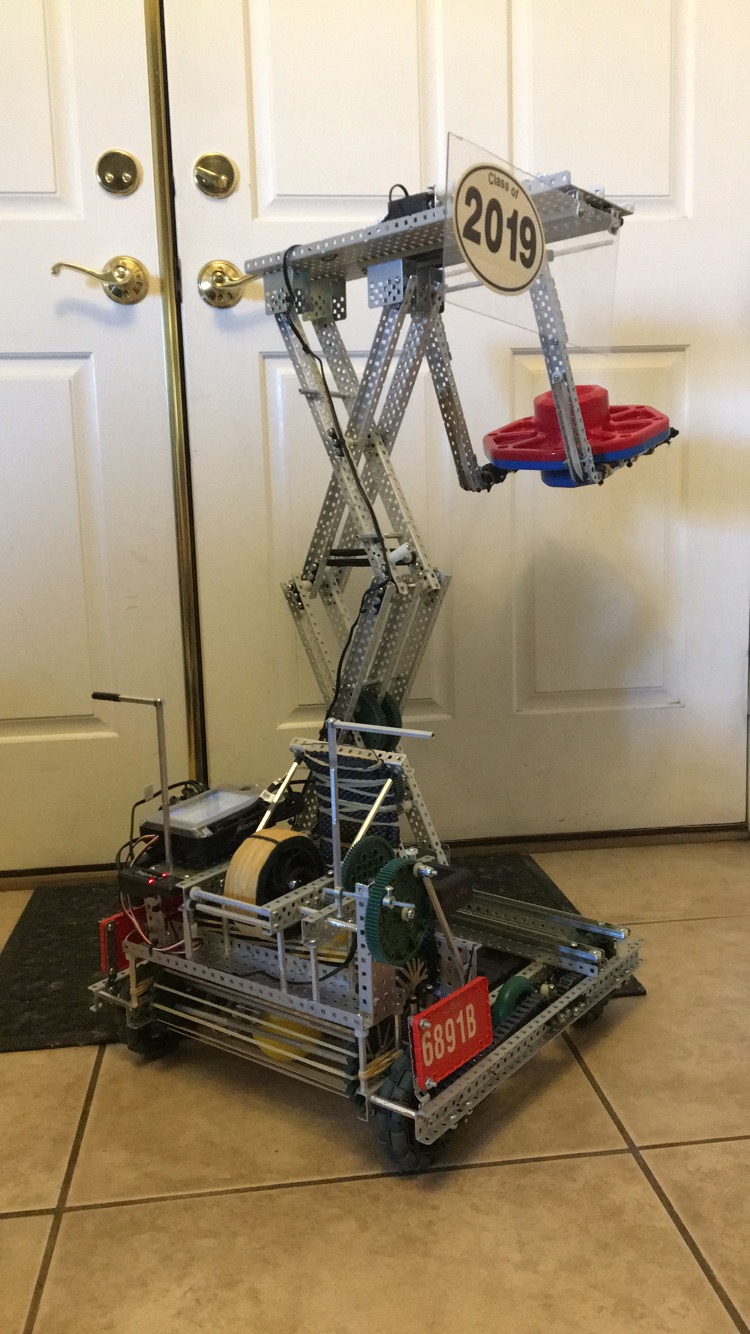

I got the Create Award at the state competition with my scissor lift. I was going to Design, but our performance in matches was very poor due to disconnections and brain ports dying. Having a claw on top of a scissor lift requires a very long custom-length cable, and these tend to burn out brain ports very quickly. My team killed about 7 ports in as many days. I have attached videos of my robot (now disassembled). The one where it flips the cap is very near to its final form.
Edit: I was using one V5 motor, and I think it had a 200 rpm cartridge. I ended up with a 1:21 gear ratio because I didn’t have time to fine tune it. I also have attached some pictures.
