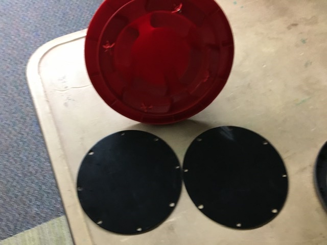

We are currently having a robot tipping issue and are trying to solve it by adding weight onto the back of our robot. We were wondering if it was legal to use the plates from the mobile goals from “In the
Zone”.
Pictures of Plates
image image
The GDC stated that using the plastic from “Turning Point” was legal and were wonder if that ruling applies to other game objects as well. Thanks for all the input in advance!

No.
Only reason flags are legal is because they are in spec polycarb, nothing to do with them being game peices
I would rule not, as they are not parts meant for building. Similar to trophies.
I thought you could use trophies as building materials also do you have specific rules that would apply to this?
Nope.
You are not allowed to use vex products not intended for construction.
Yes, give me a minute.
Xenon, I got it.

This is directly from the game manual.
Since “competition support materials” isn’t defined could you not argue that the weights don’t count as “competition support materials” and argue that the pieces are vex products that don’t cont as or that side note?
Please argue for me why a game element does not support competition.
However it also says “other non-robot products”, which clearly the game elements and trophies are…
