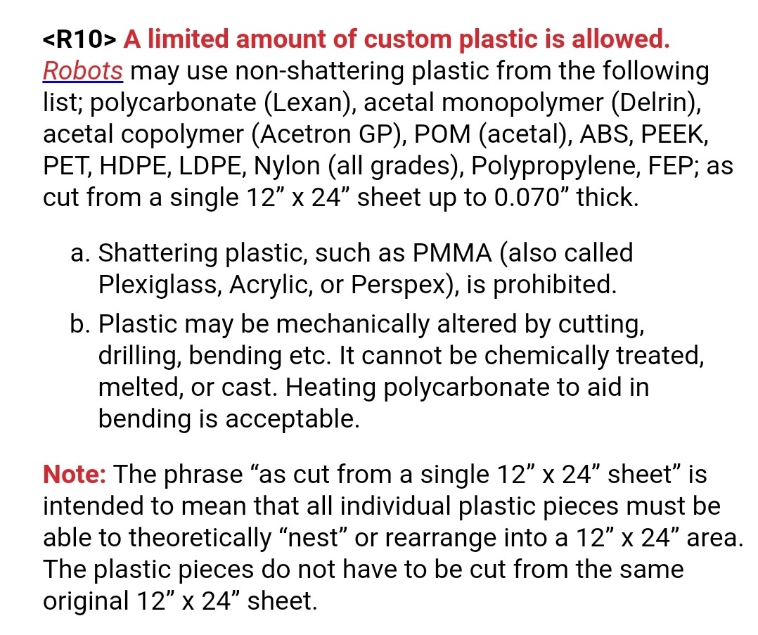

I’m guessing from R10 as long as your non shattering glass is legal it should be allowed. R10 states that your plastic doesnt have to be from a single sheet but does have to theoretically fit in a 12×24 area meaning that you should be able to use two different legal materials as long as it fits within this area.

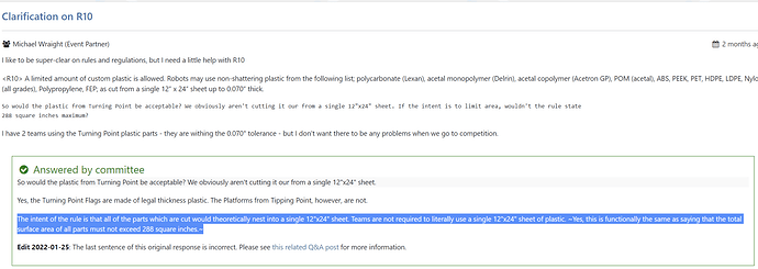

most likely no from this qna. However, I do recall from several years ago that a qna allowed different material plastics. It might it worth the time for you to ask a qna about this issue.
I’m not sure I follow why the 2 Q&As lead you to believe the answer is “no” since the clarification from the “Edit” link is about how all the parts need to nest into a single 12x24 sheet rather than not exceeding 288 square inches.
Admittedly the response (and question) do not directly address the question of different materials. However, one could make a reasonable argument that Teams are not required to literally use a single 12"x24" sheet of plastic allows one to mix-and-mix plastics, so long as all pieces on the robot can nest together within a 12x24 inch area.

In the revised Q&A it says:
nested perfectly to fit in a 12"x24" space
In the revised Game Manual, it says:
must be able to theoretically “nest” or rearrange into a 12” x 24” area
The rulebook doesnt say that it should best into a single “peice” though, rather, it says it should nest into a 12 x 24" “area” which implies that it doesnt matter if it is two different materials as long as it fits in the “area” given that both materials fit every other requirement for legality.
