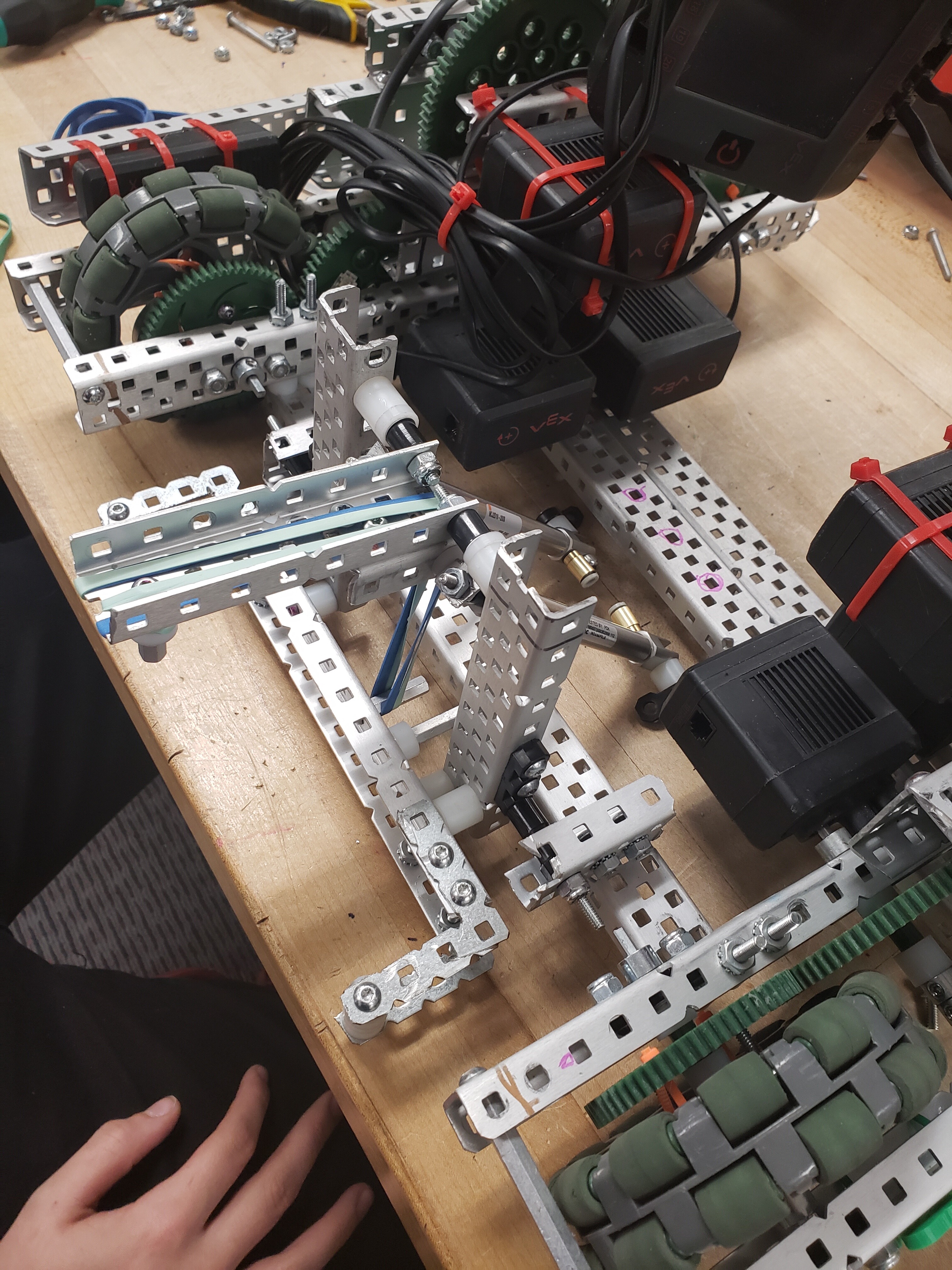

Our first prototype was basically what 2775J build with 2 pistons
With our first idea we didn’t really try to be creative since we saw an idea and we liked it, so we copied it. However, when everything was powered it didn’t have enough power to tilt the goal while also clamping on it. We definitely might have messed something up in the build process, but we tried to fix it or reinforce it, and it didn’t have enough power.

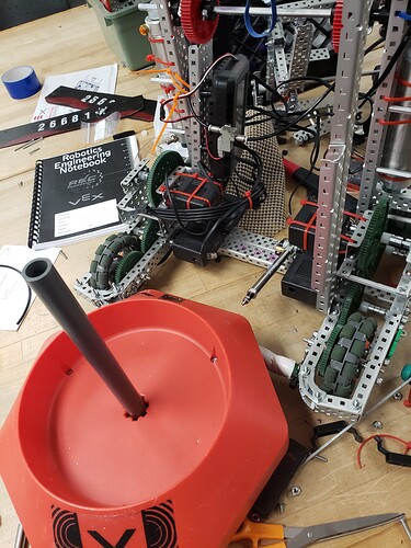

Our second actual attempt came from us only, because we new that since we’re one of the only teams out there making a mogo tilter out of single acting pneumatics we probably should come up with our own design.
Note that this was 100 percent a prototype and it never made it out of that stage, so we never fully installed it. You can kinda tell when something isn’t going to work. We know why that didn’t work since the the angle was only enough for clamping and not pulling so we added a piston that would pull the goal in reverse, but that (althought it somewhat worked) took way too much space

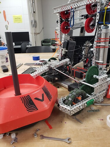

We attached the piston from those towers and this is a picture of it taken apart since I didn’t bother to take a picture of it when it was done for whatever reason.

Not that difficult really, took about an hour to make.
that’s not really my mech at that point anymore. I mean it’s not that far off, it still preserves the independent clamping/tilting motion, but the method that it achieves that with is pretty different, particular the geometry. It protrudes into the bot pretty far which might get in the way of a ring mech. But good job making those movements work with single acting cylinders.
