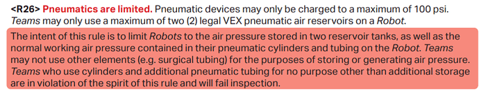

Is the number of cylinders limited?
Rule says the maximum of air reservoirs is 2 . But I don’t see any restriction on cylinders.
Does it mean unlimited cylinders ?
You read the manual correctly, there is no limit on the number of pneumatic cylinders.
If by cylinder you mean piston or actuator then yes there is no limit.
Do note that each tank is limited in the number of actuations and by adding more actuators you reduce the amount of uses overall. You also introduce a greater risk of failure of the system with the more connections you create so be prepared to spend a fair amount of time to find leaks.
