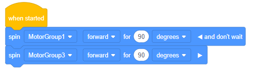

I need to get my robot to turn during auton and don’t want to have to switch motor values during auton, we want to be able to spin each motor group the opposite ways at the same time during auton thanks for the Help!
Yes, this is definitely possible. Blocks or text? If using blocks, you can use the white arrow at the end of the block to extend the “and don’t wait” part:

These examples would spin both motor groups 90 degrees simultaneously.

The order is vital. The first line with the extra “false” parameter has to go first, then the second line without it (or add an explicit “true” to make the parameter counts match and the code more readable by someone else, but hey, that’s just good coding practice talking).
