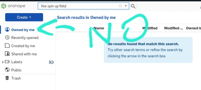

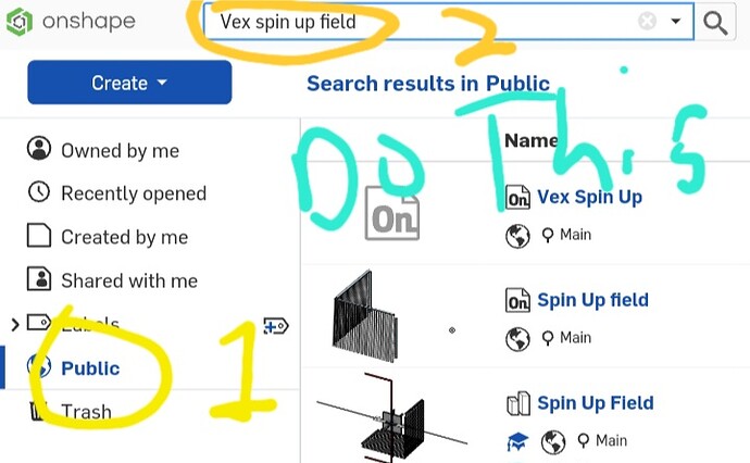

Be sure that you’re “searching in public” (see below:)
And NOT “searching in Owner by Me” (see below:)
There are quite a lot though, but I know that some dude called Coach Palardy makes some good ones.
