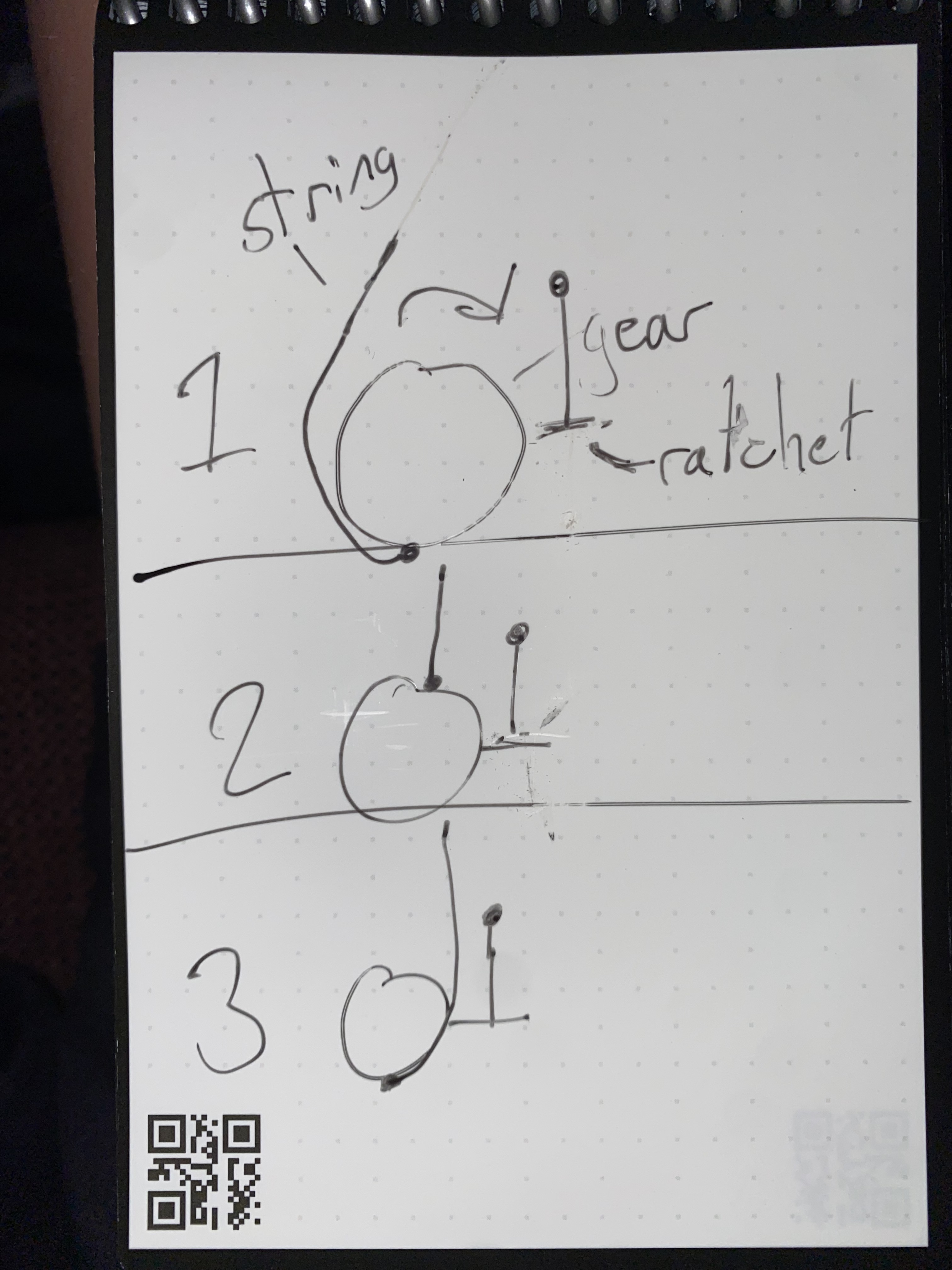

So for high stakes we want to do a winch climb to do max tier hang but we have no pneumatics so we don’t know how to do it we are planning on 1m intake 4m drive 1motor mogo and 2 motors left for climb.
You can use a racket on the main gear. For it to start down you can move it back further so it lowers the height of the string. Then it spins forward and the string raises. Then it spins forward again and the string lowers
Note that a winch hang will be hampered by the no breaking the plane of more than 2 rows rule
:sob: Yeah I was planning on doing a sort of “grappling hook”, where I would launch a hook on the top and winch my robot up. But back to the drawing board I guess…
