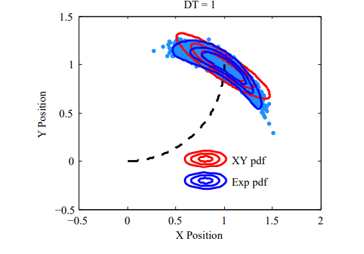

Back to the consistency question, couple years ago on discord when talking about this approach I made this plot. It shows 100 trials where it drives the same distance and turns the same amount but where every time step there is some random noise on how successfully you turn. Like if the field traction was ever so slightly different or didn’t have a perfectly consistent tuned PID loop, or your weight distribution was weird. How well you deal with these factors the tighter the grouping is at the end, I did arbitrarily set the random noise to make the point.
So you achieve the same total distance and total angle change but unless those distances and angles were synced perfectly every trial would take you somewhere a bit different.
And to @Bb3456 I am going to answer your question. I just had the answer for @2775Josh handy.
Not saying anyone should read this but here is a well known paper talking about how the shape of points created by my plots above(the so called Banana-shaped distribution) can be modeled. They say the shape comes from gaussian noise on wheel positions when doing odometry. (odometry and this curved trajectory problem being closely linked)
http://www.roboticsproceedings.org/rss08/p34.pdf
You can see when they try to compute where a robot must have ended up giving a distance traveled and an angle change with noise on the measurements they get the robot could have ended up at any of those blue points. The plots are them trying to fit a distribution to the data so they can say with what probability you are in a specific region. Specifically the insight of the paper is not to consider the noise on the final position but the noise on the specific wheel motions and how that change in heading changes the final position. (Exp better than XY)
@nickmertin @Andrew_Strauss Did you guys end up looking at anything like this in your odometry research in the past? The standard equations effectively do the optimal thing, which is find the mean of the distribution, and this paper is more about how you can think about how uncertain you are about the position.
