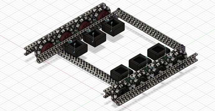

Hey so me and my teammates are planning on going with a descoring bot for worlds and wanting to gather some opinions on our drive train it is 6 motor 600rpm on 3.25 and we just wanted to see if other people thought it would be a good drive base we wanted to be really quick on the field and still have a decent amount of torque

Forgive me if my calculations are wrong, but your drivetrain seems to go 102 in/sec. That’s really fast. For speed it’d be almost twice as fast as other robots, but torque may be a concern (unless you plan to make a PTO to your drivetrain for your other 22w)

The short answer is no
The longer answer is heck no.
102 in/sec is extremely fast, no team has ever (really) been competitive with over 86 in/sec
This is your problem, you’ll be very fast, but you’ll have minimal torque. A couple of things that you could do are a) move your motors to the 36-tooth gear, giving you 61ish in/sec (assuming that those are 36 and 60-tooth gears or b) change those wheels to 2.75-inch wheels, giving you 86ish in/sec, fast but still having a semi-decent amount of torque. If you do go with the second option, you should probably change those 60-tooth gears to smaller gears (48?) to prevent the gears from scraping the ground, although you probably won’t need to because your robot should be pretty light as a descoring bot.
Tl;dr: It’s probably too fast with too little torque

Torque aside… your driver will need to (re)learn new methods of driving. The bot will carry considerable inertia at these speeds. Handling will be different also.
Other than that… I say go for it. Put all your strengths into one attribute.
If you do a 8 motor 600 3.25 ou will be fine. Its what 4082B did at their last tourament. They couldnt get to top speed tho with only 6 motors in skills. tip: just go 600 2.75
Consider actually reading the post, and you will see that OP said
6 motors would not get you enough torque to really be competitive, 8 would probably be fine, but still unadvisable in my opinion.

While this has already been said, I would really like to stress how little torque you will have. 6 motors on 2.75 for 600 RPM is probably the highest competitive speed that has ever been done, and even those robots struggle with torque. Pushing that yet again would mean so little torque I doubt you could actually accelerate to top speed. Furthermore, the torque deficiency caused by this setup would make it almost impossible to descore, as it takes a fair bit of torque to descore on a new field.

Hi so do you think maybe 450 rpm might be better then as this has been a common speed most teams have been recommending and seems it might the best balance between speed and torque
Oof, 76 in/sec is quite fast. Torque is a lot better than 600rpm, but still might be an issue when you’re pushing other robots/descoring a packed net unless you use 77 or 88w of power. I would go 400 rpm on 3.25 omnis, which is a good speed of about 68 in/sec and has good torque for descoring.
