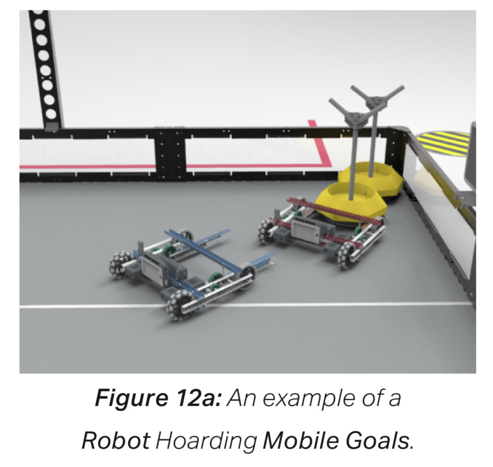

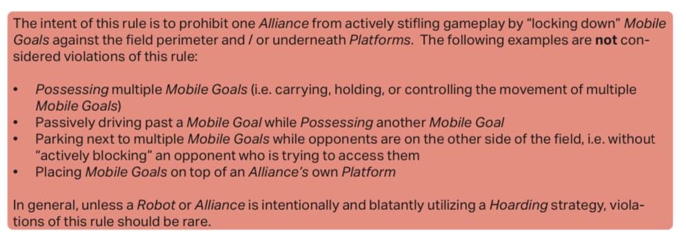

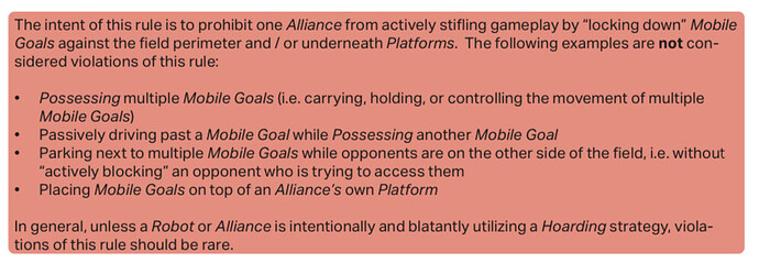

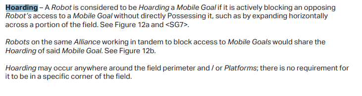

When asking in regards to a different situation a definition of hoarding was given that followed the game manual’s wording. Outlined by Figure 12a
Yeah he should be Able to send it eventually.
I think it comes down to was ever goal in possession or not, since any non possessed goals would be hoarding, our belief was that one or more goals was not In possession justifying hoarding. Hopefully you can understand the conclusion.
If they werent in possession (moving goals through transfer of energy from robot to goals) then they were hoarding and was match affecting, which should have been a DQ

This is hoarding as the robots blocked the other team from getting the goal.
