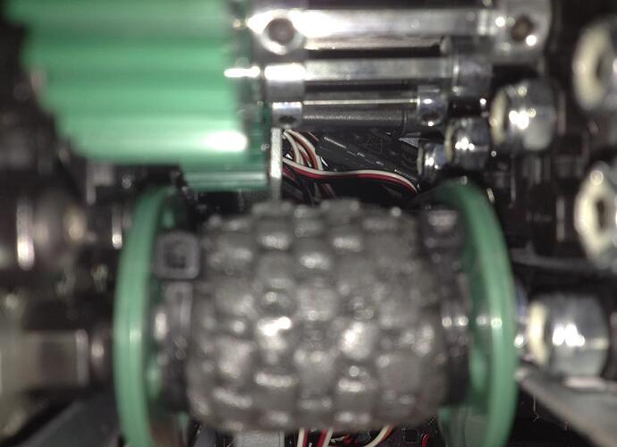

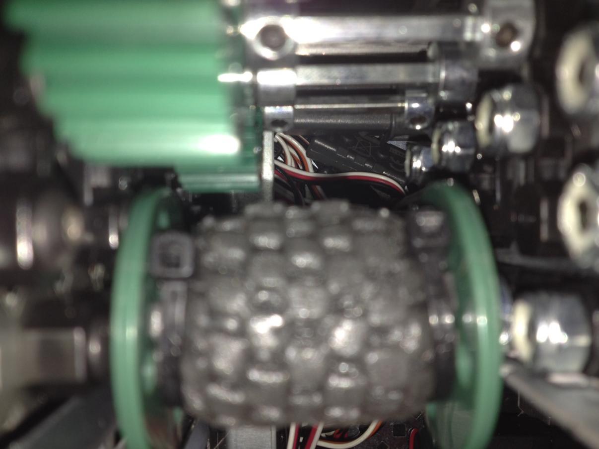

1)the drum is from the winch and pulley kit sorry for not saying that sooner
2)we plan to increase the diameter because our lift takes too long to fully extend so we decided to increase the diameter to make each rotation pull in more string the plan is to take the 3/4 inch diameter drum and hopefully get as close to 1 1/2 inch diameter
3)we dont use the housing that comes in the kit we went with our own custom system so that we could use two motors instead of one
if someone can tell me how to post pictures I will show an idea we had of how to do it
[ATTACH]5110[/ATTACH]
this is what we were thinking of and sorry about the size
Again, this isn’t an official thread, but I see no reason as to why this wouldn’t be legal. Its all VEX parts and you aren’t really “modifying” any of them to an extreme extent.
Just my opinion
its legal but why wouldn’t you just put standoffs into the preexisting holes if you wanted to make it bigger or use a different gear combination if you want the speed
We tried changing the gearing to make it faster but we had a lot of problems with chain and we need to stick with the high strength gears and we tried faster ratios but it just wasn’t working the same and thanks for the standoff idea
I would suggest getting another length of rope and winding that around your winch to give it a larger diameter. It will squish less than the anti slip mat and is definitely legal.
