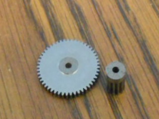

Is this supposed to happen?
There is a 10 character minimum :rolleyes:
It certainly happens sometimes. Careful use of motors will make it less likely, but this is probably the second most common way in which the 393 internal gears break. (The most common is a tooth breaking off on the gear that holds the axle)
