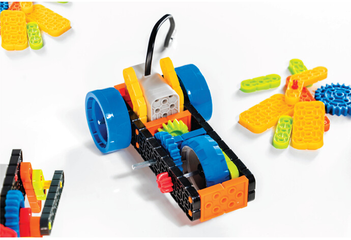

So guys I was seeing the Vex go parts and they are similar to Vex IQ parts so I was wondering that if we have Vex go parts on Vex IQ would it be legal in Vex IQ competition or not. Here is a ImageAnnotation 2020-07-18 154424 if you do not Believe me

That aside, it looks like the structural elements (beams, corner connectors, etc) are the same parts that come in the IQ kits, just in unusual colors. If they have the same part numbers. If you get some “VEX GO parts” and they have the same part numbers as “VEX IQ parts” (see this page for finding part numbers), then they’re the same parts and thus are legal for use in IQ.

The best answer is that you can as long as it’s in the parts appendix. The pins for VEX GO are different, and have a hexagon shape to them so you can tell the difference. They are intentionally made to be easier to remove, so they wouldn’t give anyone competitive advantage anyway.
