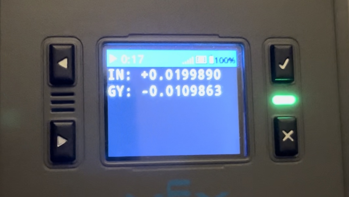

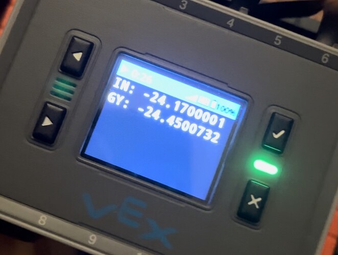

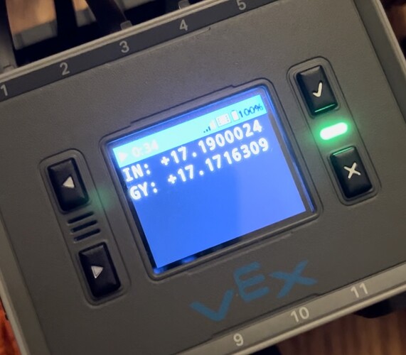

Circling back to the original topic, @Ali_Behram_Albayrak, once my kids are in bed, I’ll record a quick video of the differences showing on a Gen 2 brain (which is how I was comparing them).
@Ali_Behram_Albayrak Pictures instead of video as promised (apparently can’t load videos anymore). Top line is inertial to 6 decimal digits, bottom line is gyro. Long calibration cycles for both.
Gyro is basically center of the robot, brain centered over the top of that. As you can see from the video, not a lot of difference between the two, but there is some.
