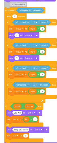

attached is a pic of the issue but basically, the output it produces is meant to be 1-4 but is coming back as 100+

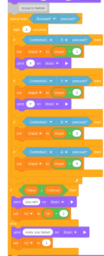

This is a little hard to diagnose without seeing the rest of the code but from this screenshot I can tell you that unless the input variable is being reset every second, then each time you press the 4 input buttons it just keeps adding value to the input variable.
yeah after messing with it over the weekend I found of if I set it to wait 1 sec before it runs the input code it works. but like normal with vex stuff the error wasn’t in the product instead it was in the user
